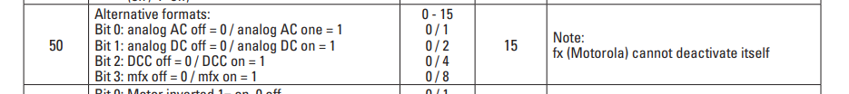

- you may block the MFX protocol at the CS3 level (it would be a bad restriction on something very powerful). I authorise all 3 protocols
- you may block the MFX protocol at the loco level (depends on your decoder type). Märklin uses CV50 to block/authorise protocols. This helps barring the loco from any MFX registration

- I believe it is best to disable the unused protocols at the loco level (depending on which decoder brand you are using the disabling may change)
- remember that you cannot disable the protocol you are presently using to talk to the loco (so you may want to connect using DCC to disable the MFX protocol) and then delete to possibly created MFX registration.

No. you are absolutely right (and I have done it but forgotten). YES you must first disable (temporarily) the MFX protocol on the CS3. This is the only way to "talk to the loco" in DCC.
Then disable on the loco the MFX protocol, remove any possible MFX registration on the CS3
Finally you may authorise back the MFX protocol because on recent Märklin locos, it is so much more convenient.
