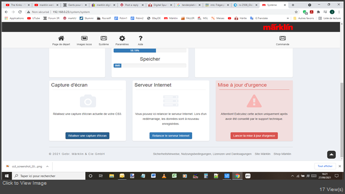

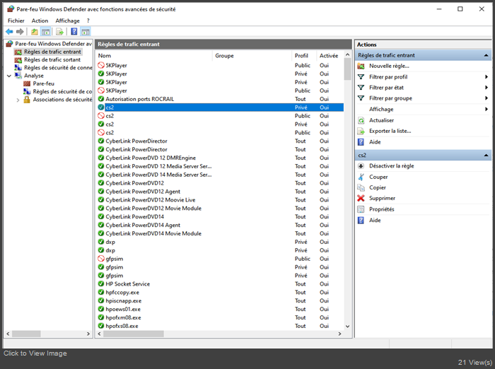

In my post there was a mistake, Sorry. The address of your CS3 must be followed by :5900 (and not by :59)
If it does not work after installing properly the VNC Viewer
You can download it here https://www.realvnc.com/en/connect/download/viewer/
One possible cause of your problem is the firewall I use Windows 10, last version together with windows defender and I have declared my CS3 and its application to let the data through
I hope this helps

Originally Posted by: BOOMerCH Go to Quoted Post
About the firewall I tried to deactivate it (windows 10 and router) and still not working. But I would be interested to know what you did to declare the CS3 and its application to let the data go through.
You go to Windows security then select Firewall
Then you go to "Authorize an application"
You may also go to advanced parameters like here to authorize a CS2
Note: before disturbing the firewall settings, just try - with internet DISCONNECTED - without the firewall.
If it works ONLY then you have a firewall issue.

Strangely, on the webserver screen you have the possibility to restart the webserver screen (How does Märklin suggests you restart it when it is not working?
OK let's pass this as on the CS3 the "restart applications" function reboots the CS3
