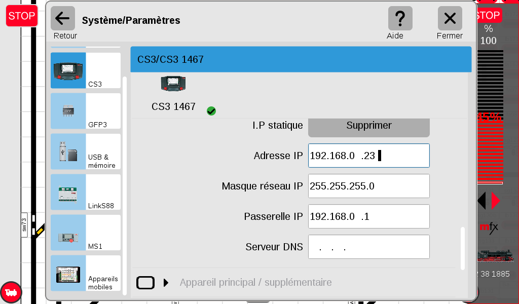

Hello Jean,
I think this screenshot is from the previous version of the software. This is also what I had before upgrading to v.2.4.0, and it was saved after each session...
In the new version, the option "manually" is not there anymore, instead, at the bottom of this screen you have a button to "Add" a "Static IP address"...
And this Static address is not saved automatically at the end of each session...
#7 Posted : 22 March 2022 14:13:02(UTC)
Posts: 3,728
That is true, the screen copy from a previous version
Here is the same screen (Lower part of screen, the upper part is empty) with version V2.4.0(5)
Of course, if you start filling the upper part of screen you may be activating the dynamic address (DHCP)

#9 Posted : 22 March 2022 14:49:43(UTC)
Posts: 3,728
I don't know the difference between your CS3 and mine as mine remembers the static address without me doing anything.

#10 Posted : 22 March 2022 15:06:26(UTC)
Posts: 3,728
Looking further into this with the CS3 connected to my PC
I have the following screen
This shows in my case that the CS3 has stored my address in the DHCP mode, showing there is clearly a bug in this version V 4.2.0 (5)
I would try to add a static address ("Statische IP") USING your PC and browser (AND NOT the CS3 directly). It may offer a turn-around the bug
