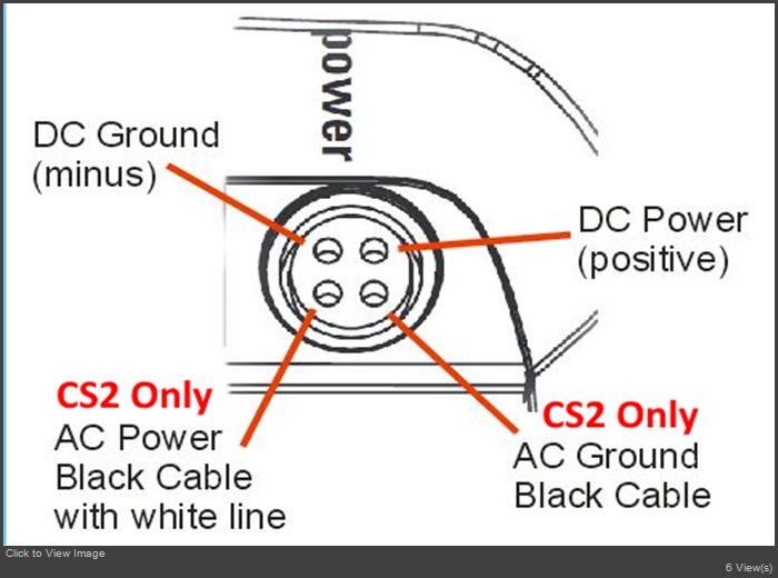

.Hi Carlos
French user of 2 CS2s (60215) and one CS3 (60226)
The power supplies I have are 2 60041 (230 VAC 60 W) and one 60101 (230 VAC, 100W).
So rhfil suggestion to check if power is present on the plug is good (or thying from a different wall plug is also good)
The low voltage output on the CS2 and CS3 (same connector, same pin-out / pin assignment) is as follows (as viewed from the CS3 vewpoint)
This would allow you to check if your power supply provides 19.3 VAC.
Make sure you don't short-circuit the 2 pins as it would stop immediately your PSU and force you to unplug before restarting the measurement.
If the PSU does not provide power and if it is not under warranty then:
- Märklin won't repair them
- on TWO occasions it happened to me that a wire inside to connector plugged to the CS2 / CS3 was cut and all I had to do was to open the connector (rather difficult) and resolder the wire.

.Hi Carlos
Here are the connector parts when opened
Hi Jean I used a multi-meter and according to the multimeter there is no problem I also plugged in another outlet and the problem still the same. I believe I'll need a new CS3+
Thank you for your help
Carlos
