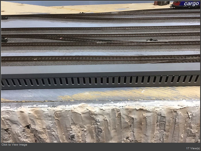

Call it what it is, A dogs dinner, a bowl of spaghetti, a birds nest, just to name a few of these wires going here, there and everywhere!
My solution was an easy one since most of the electrical cabinets at work had these so I thought why not use them on my layout. I’m referring to wire ways! At work they were metal and so I sourced the plastic ones.
I’ve been creating and making model railroads for quite some time and these wire ways are in my opinion a necessity. For about $15.00 you can buy a 1 1/2” X 2” X 96” plastic wire way from your favourite electronics store. With the wire way you can put it in any orientation, cut it to length and best of all have, all your wires will be in a convenient location for that potential and inevitable trouble shooting time under the table!

Those plastic wire ways are great! I made stick on labels for each turnout run, decoder, etc. And wrapped them around the bundles. That way you know which bundle is which underneath. I hid topside labels under landscape that can easily lift up. Even using red, Brown, green, blue, black and yellow wiring, it gets to look complex. The more you multiplex lighting to save wire use, the more so it gets.
Then even though several bundle runs are concealed carry in the channel ways, if the exit areas are labeled, there is no confusion.
