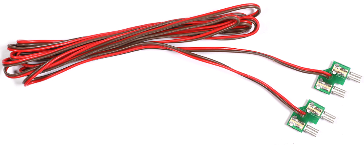

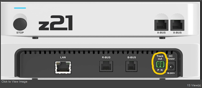

How do we connect the 74042 to the back of the Captura de Ecra (1163) - Copia_LI.jpg z21?
1-do we cut one end and make a connection to a green phoenix connector?

#2 Posted : 22 April 2021 15:13:54(UTC)
Posts: 15,578
Originally Posted by: Lusito Go to Quoted Post
How do we connect the 74042 to the back of the z21?
Cut the 74042 in the middle and you have two feeder wires. Use a plug at the end.
When the layout grows you can use a bigger bus wire. When you make your own feeder tracks, you can solder the blank ends to the tabs of the C track.
I would not trust the plug connections for C track that is glued or screwed to the layout.

Offline Lusito
#3 Posted : 22 April 2021 15:26:13(UTC)
Lusito
Joined: 26/02/2021(UTC)
Posts: 6
Location: Porto
Hello H0
Thank you very much for your reply.
Cutting the wire in 2 parts is a good idea!
