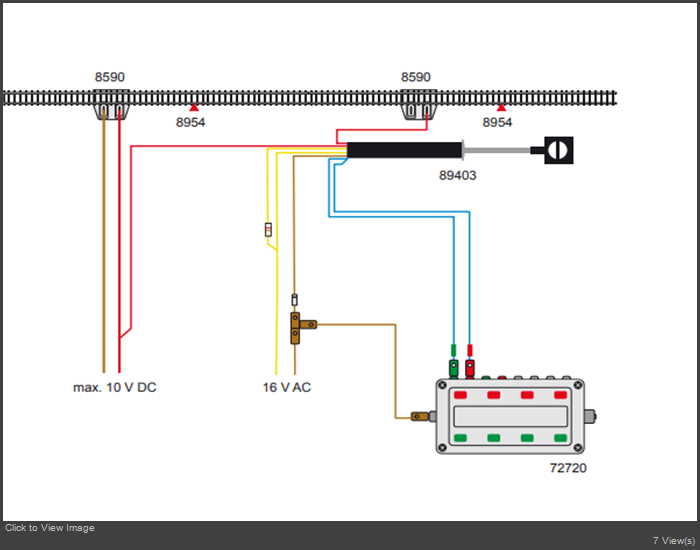

Help please with clarifying the function of the many leads attached to this signal.
I have managed to get the semaphore disc to move but cannot seem to connect the wires properly to get the lamp to illuminate. Which (colour) leads supply the lamp? From the manual there seems to be a lead from the signal to a track feed - what is it's function and does it affect the signal lamp?

Here is a small drawing of the needed connections
You will notice, there are 2 yellow wires, one with what seems to be a resistor to light the LED and the return is through the brown wire
Insulated track section freed is though the red wires.
The 2 blue wires are to control the solenoids (return though ther yellow wire)
