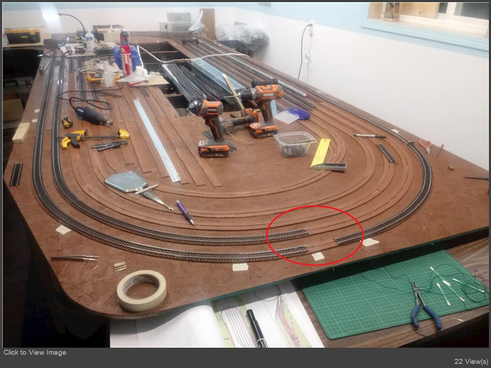

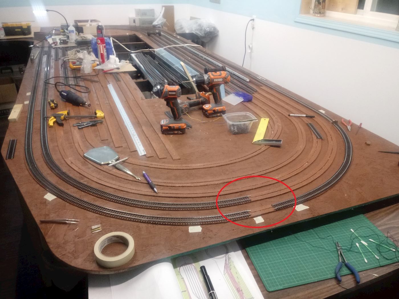

Hello
I am in the process of building a K-track layout.
It will be a digital layout using an Esu Ecos controller and RocRail on Windows.
I would like to plan ahead and prepare the layout for the possibility of using a booster or two as needed.
With that in mind I have divide my shadow station into two power consumers, the "entry loops" six tracks and the "exit loops" also 6 tracks.
At this point, circled in red is where the power division is.

Thanks Tom for your reply.
Sorry that my picture was a bit misleading.
I have six "runs" in the shadow station that are made-up of six tracks that come from the helix and then run around the lower level returning to the helix back up to the main level.

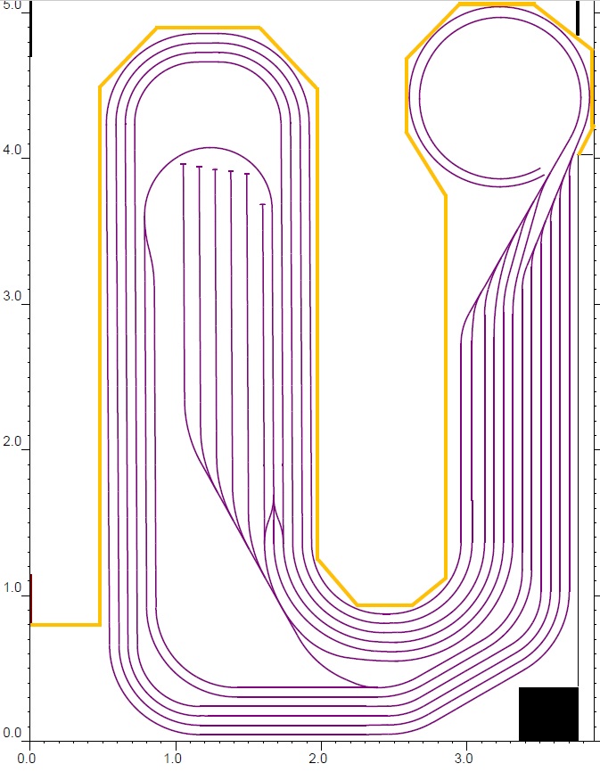

Here is a picture of the track plan

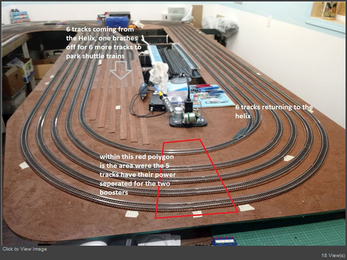

Here is a picture of the completed section (that I just finished this evening) hopefully it is clearer now.
OK that is good to know that a common ground is acceptable using the ECoS controller and a booster.
So there is no problem now ThumpUp.

#6 Posted : 23 November 2021 07:47:49(UTC)
Posts: 15,578
You do it as you want it.
My remark was about "load balancing". And about reducing transitions from one circuit to the other.
If you have six trains running, then in an ideal world three will be in circuit 1 and three in circuit 2. If it is six versus null then all power will come from a single booster.
When the rails are not yet finally fixed, then maybe consider making four or more circuits. You can still run them from one booster, but have more flexibility when that single booster reaches its limits.
