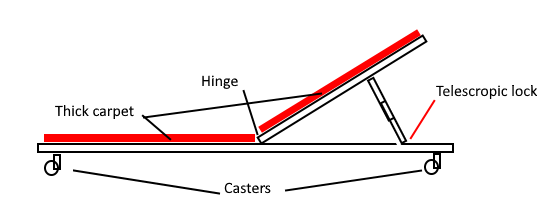

#8 Posted : 06 March 2021 01:30:50(UTC)
Posts: 3,730
Hi Mr Ron
One possibility for you is to make a sort of long chair mounted on casters: an horizontal rectangle with another rectangle to rest your back and your head. This one need to be adjustable so that you work at a confortable distance
You can even manage to attach a powerful LED light and some extra surface to leave tools and wire coil
This is frequently used by mechanics to crawl under a car.
Don't laugh it is an idea I will make for me (75 and tired of crawling under the table) and when properly done, it is much more confortable on this than being bent over the table
