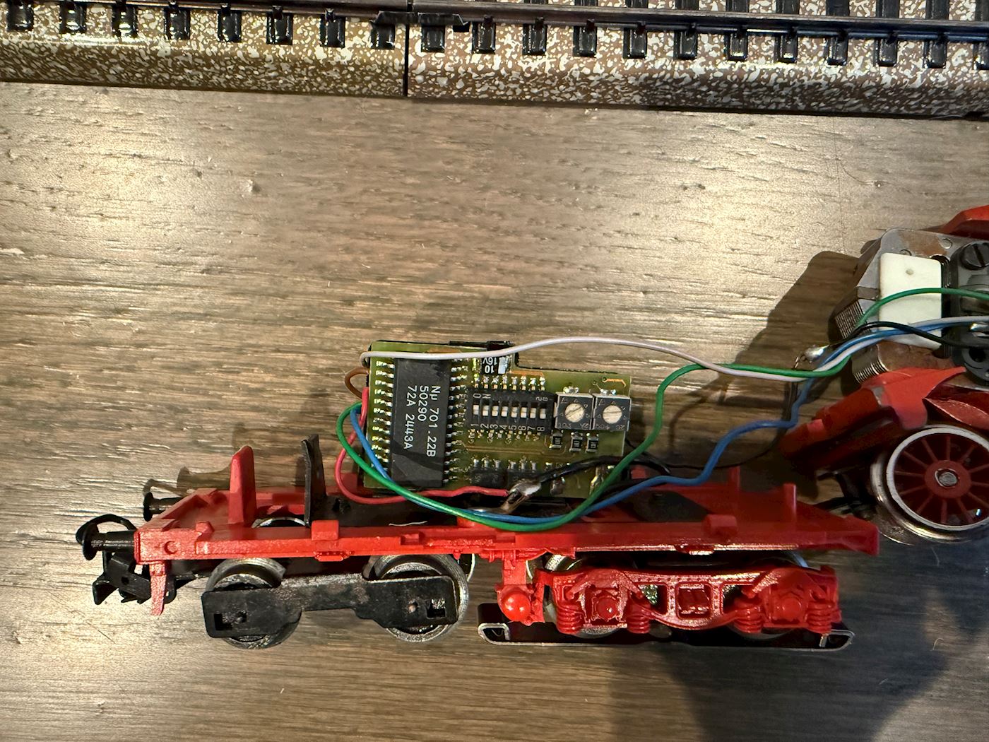

Makes this weird noise. Please see video attached IMG_7704.mov (15,384kb) downloaded 37 time(s).
#2 Posted : 28 December 2024 20:53:59(UTC)
Posts: 8,298
Can you record a video close up (Hold your phone sideways)? Also, can you tell if the noise is coming from the tender (rear) or from the motor (locomotive).
If it comes from the tender, it may be a short on the circuit board. If it comes from the locomotive, it is likely an issue with the motor/wiring.
I did notice that no light comes on when powered.
Can you also post a bigger photo of the tender showing the decoder/PC board and the bogies?
Can you also explain whether you are powering up the track or attempting to reverse the direction?

Attaching more videos and pictures. I am powering up the engine and the noise starts immediately. I suspect a short circuit somewhere. IMG_7708.jpegIMG_7707.jpeg IMG_7705.mov (15,583kb) downloaded 20 time(s).

I haven't listened to the video, but could almost guarantee your problem is the engine needs a drop of oil on the motor bearings. A tiny trace on the gears and axles as well will help the running.

Does the motor turn at all? Are the brushes / coals OK?

looking at the magnet's level of corrosion I agree with KiwiAlan. A drop of oil on the motor and on the axles.
I would also check that all cables are soldered properly, corroded solder points aren't good for circuits

Surely, as it appears to have been ina damp environment.
