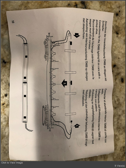

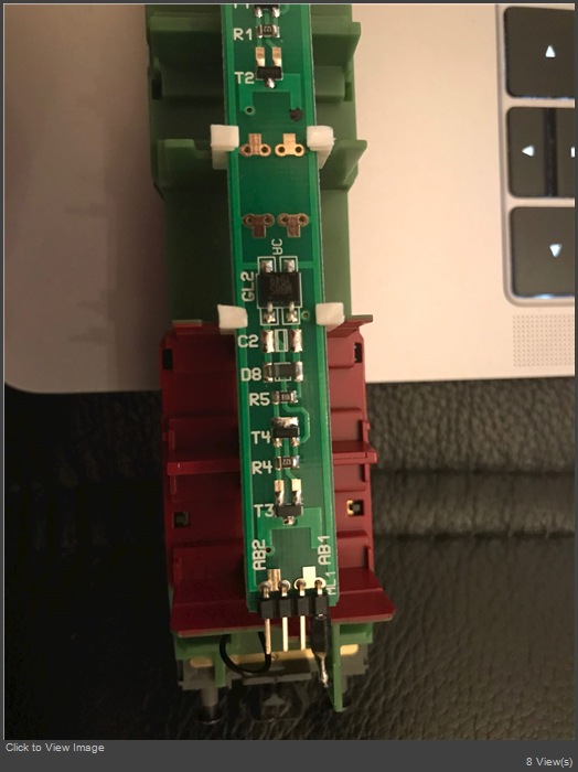

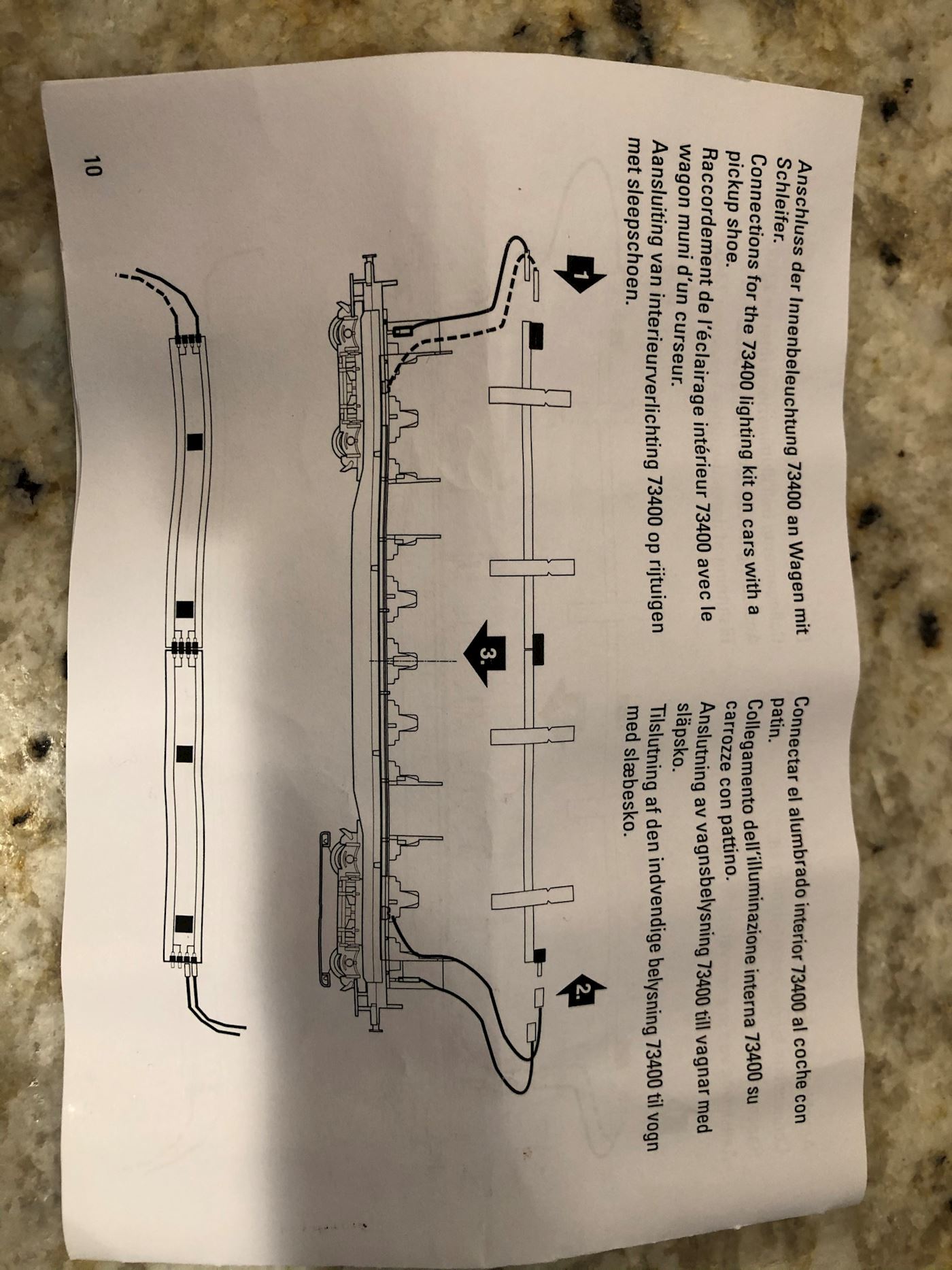

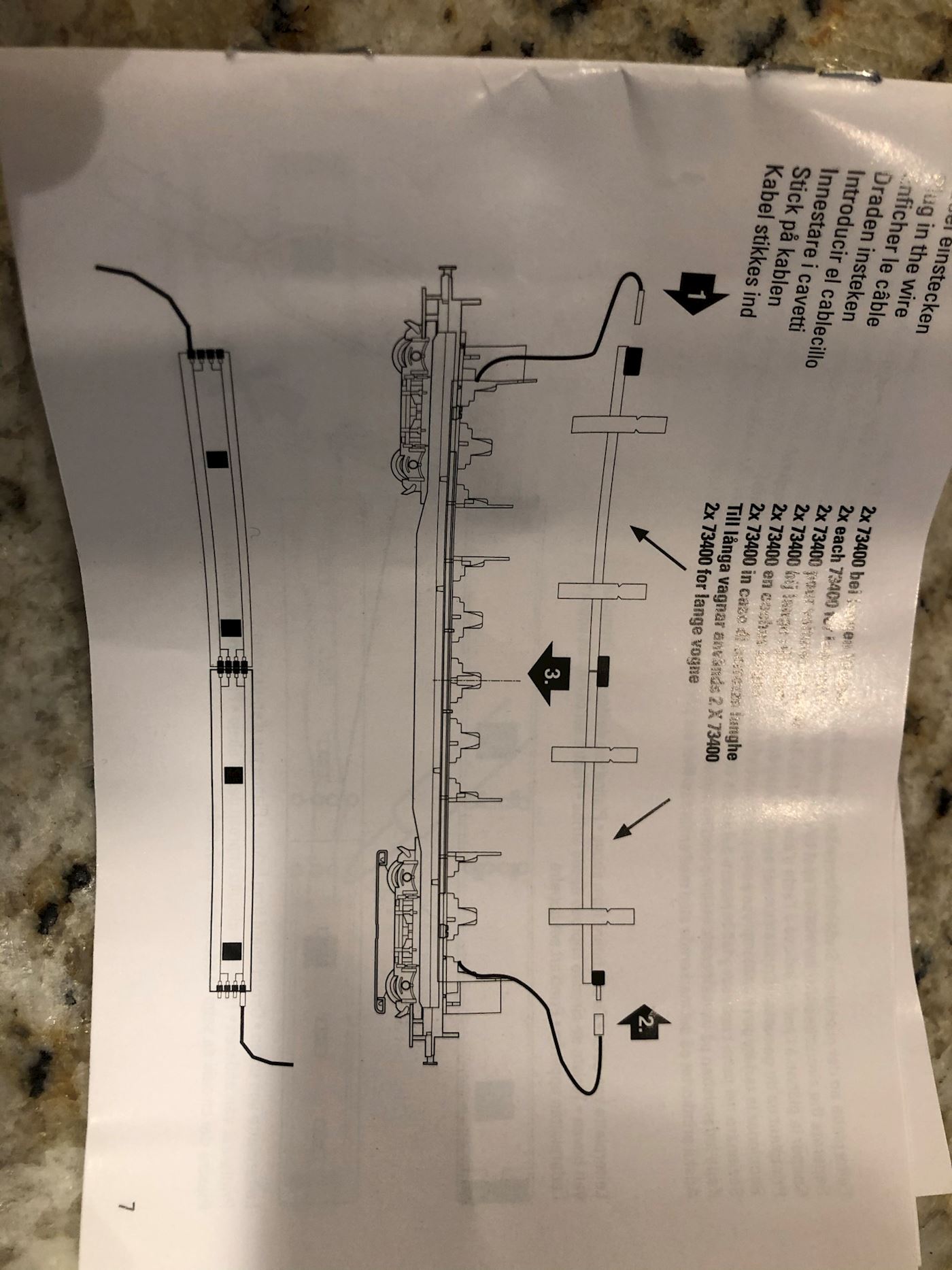

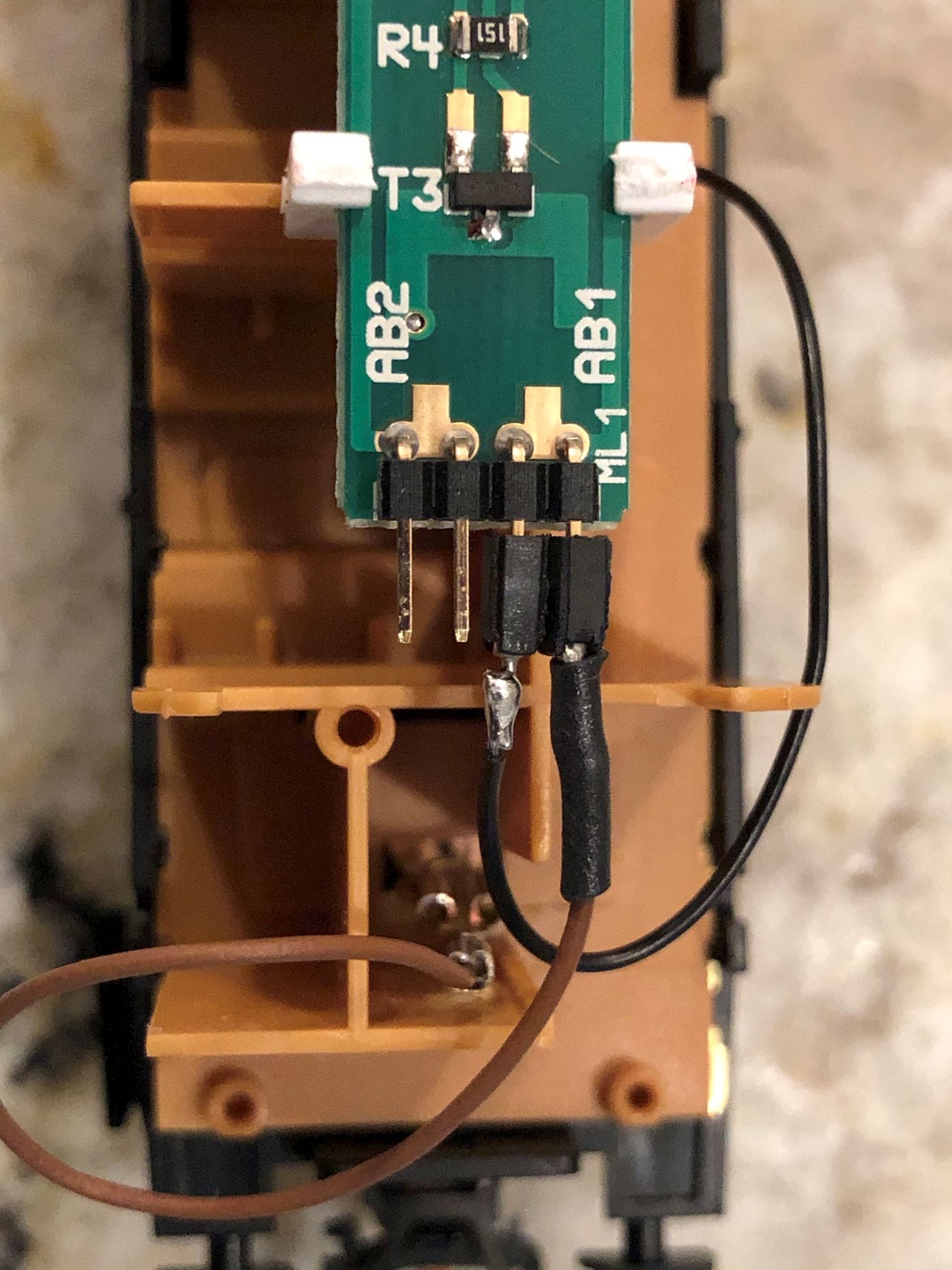

I recently purchased the current conducting close couplers #72021, pickup shoe #73404 and lighting kit #73400. I wired the assembly according to the instructions (which are inconsistent). As soon as I place the car on the track, the system short circuits. I have tried re-wiring in different combinations, to no avail. The wiring instructions that came with the 72021 and 73400 are inconsistent! (See pictures). I have also included photos of how the car is currently wired. I must be doing something wrong. Thank you to anyone who can give me some insight!

I took one of my SBB Lightsteel coaches.
The first photo (1960) shows the end with the return (leftmost) and lead to baseplate (coupler) rightmost
The second photo shows the other end with the lead from the slider (live) on the rightmost pin.
You have the lead from the slider (black) going to the second pin from the right. This is WRONG.
It needs to go to the rightmost pin. Try connecting it that way and then testing to see if it works.
If it works, you can then connect the lead to that end's baseplate to the second pin to the right.
#4 Posted : 25 March 2021 04:19:03(UTC)
Posts: 8,260
Did you modify the solder on the wires? The lead from the slider seems to have excessive solder on it.
A few more things that you should check...
1) Check the contact which goes underneath the baseplate and goes to the coupler to make sure that it is not coming into contact with the axle/wheels
2) make sure that the coupler is properly inserted and not bending or otherwise not properly contacting the contact strip in the coupling shaft.
3) DO NOT couple this coach to any older coach or car or locomotive with metal couplers. The old metal couplers were connected to the ground (return) via the chassis, so this would result in an instant short.
4) If you are using this with additional coaches, make sure that all equipped with lighting and 72021 are connected in the same way so you are not crossing live with return in different coaches.
If one coach is wired AB and the other coach is wired BA, this would cause a short.
Make sure that only one coach is equipped with a slider. the others should be connected with one return lead and baseplate leads on the opposite side (outer) to pass the live to the next coach via the couplings. The coupler connected to the locomotive should be equipped with a 7203 (non current conducting) or you can remove the baseplate lead on the corresponding end of the first coach.
