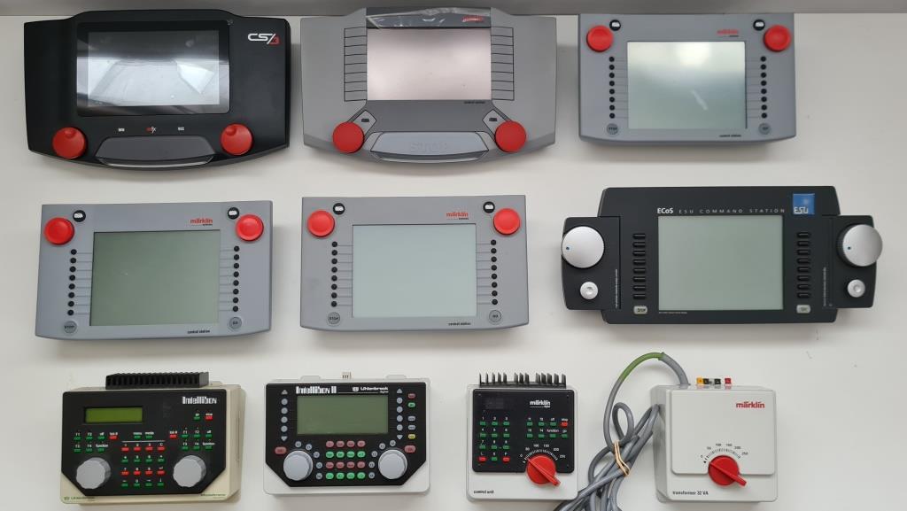

#23 Posted : 11 October 2021 01:18:56(UTC)
Decisions, Decisions.......
A picture of my controllers, not including MS1 and MS2's
At top you have the CS3, CS2 and three CS1's. The black unit on the right is an early ESU Ecos and at the bottom we have an early 650 Intellibox 1, Intellibox 2, a 6021, and a good old analog controller.
I still use most of them, although not so much the CS1's.
If you are happy with the older technology I don't see why you can't stick with a 6021, the extra keyboards, Control 80f units, etc are all much cheaper now than new.
H0Donb
