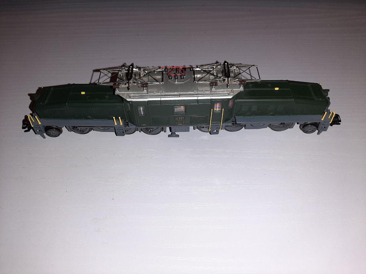

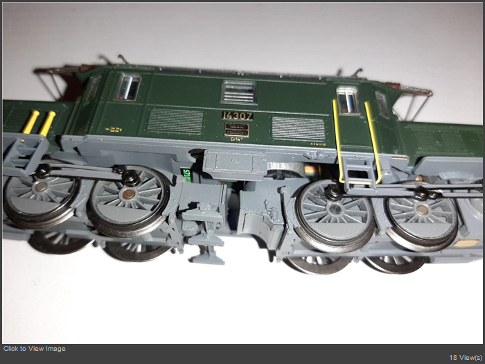

Offline Keyes43
#7 Posted : 26 December 2019 23:14:10(UTC)
Keyes43
Joined: 26/12/2019(UTC)
Posts: 7
Location: Zurich, Zurich
Here are some pictures as requested. Getting proper lighting wasn't easy, hopefully this is fine. Please let me know if you need more pictures of specific parts or details.
photo_2019-12-26_22-51-04.jpgphoto_2019-12-26_22-57-32.jpgphoto_2019-12-26_22-57-37.jpgphoto_2019-12-26_22-57-59.jpgphoto_2019-12-26_22-58-02.jpgphoto_2019-12-26_22-57-42.jpgphoto_2019-12-26_23-06-08.jpg
#8 Posted : 26 December 2019 23:17:03(UTC)
Posts: 3,541
There's no slider on that loco........... Confused
This part is missing, either never installed or removed by previous owner:
s

#9 Posted : 26 December 2019 23:27:33(UTC)
Posts: 7,579
If you are buying this Loco as new it should come complete with box and any paper work including the warranty from Marklin. I would return it to the seller for a full refund as the model is not complete (no slider). The model is now not available from Marklin.
Offline Copenhagen
#10 Posted : 26 December 2019 23:39:50(UTC)
Copenhagen
Joined: 23/04/2019(UTC)
Posts: 548
Location: Copenhagen, Denmark
What Per says, there is no pickup shoe underneath the locomotive (between the wheels to pick up power from the middle rail). I don't know if you've gotten a faulty model... or if the shoe mysteriously fell off during transport... or if its a shady or incompetent dealer that sold you the item. You can see on page 19 of the manual where the shoe is supposed to sit. Maybe and hopefully a dealer can easily fix you up with a new shoe and get the train running again.
...I can see that Per has added a picture to his post, which says everything.
Offline Keyes43
#11 Posted : 26 December 2019 23:42:03(UTC)
Keyes43
Posts: 7
s
Could you give us a few pictures of the loco, especially the undercarriage, at least as a start.
Good guess, you nailed it BigGrin
Ah, so that's probably it it then! Thank you!
Just to be sure, is the slider required on all types of tracks? I saw the slider in the manual, but I thought it was only used for tracks with a "neutral" power rail in the middle. The tracks I use are the regular Märklin tracks, with power on both sides, and only 2 wires powering them. Is this locomotive compatible with my tracks, and if so, what does the slider do exactly?
Now I'm trying to remember if my locomotives from 20 years ago had a slider as well... Confused
In any case, the locomotive didn't come with it, so I'll see about getting a replacement slider. I suppose it isn't very expensive.

#14 Posted : 27 December 2019 00:10:03(UTC)
Posts: 3,541
I hope your tracks looks like one of these, probably the one in the middle Cool
As Copenhagen mentions, the small "dots" in the middle are considered "the third rail" in Märklin terminology.
The missing slider should pick power up from these contact points.
s
