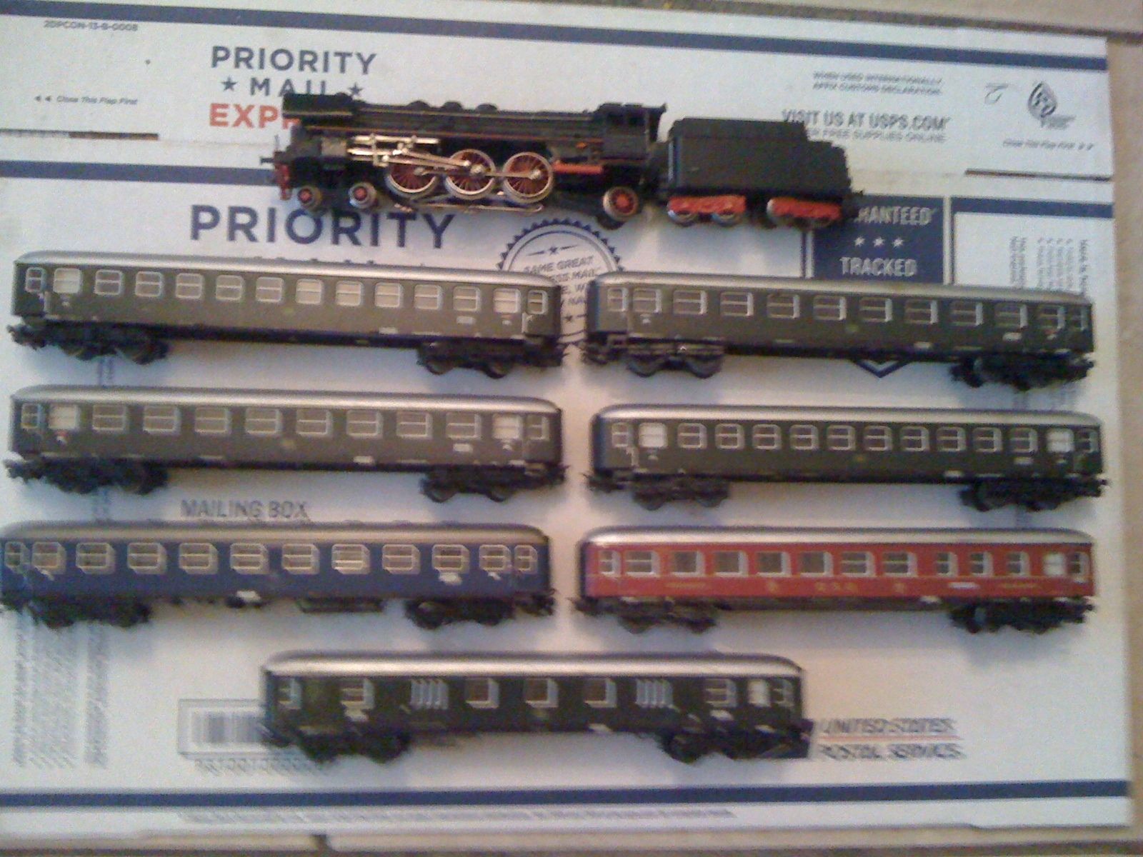

I just bought some Marklin trains on eBay. I'm going to set up a twice-around loop layout. Which model transformer do you recommend?
