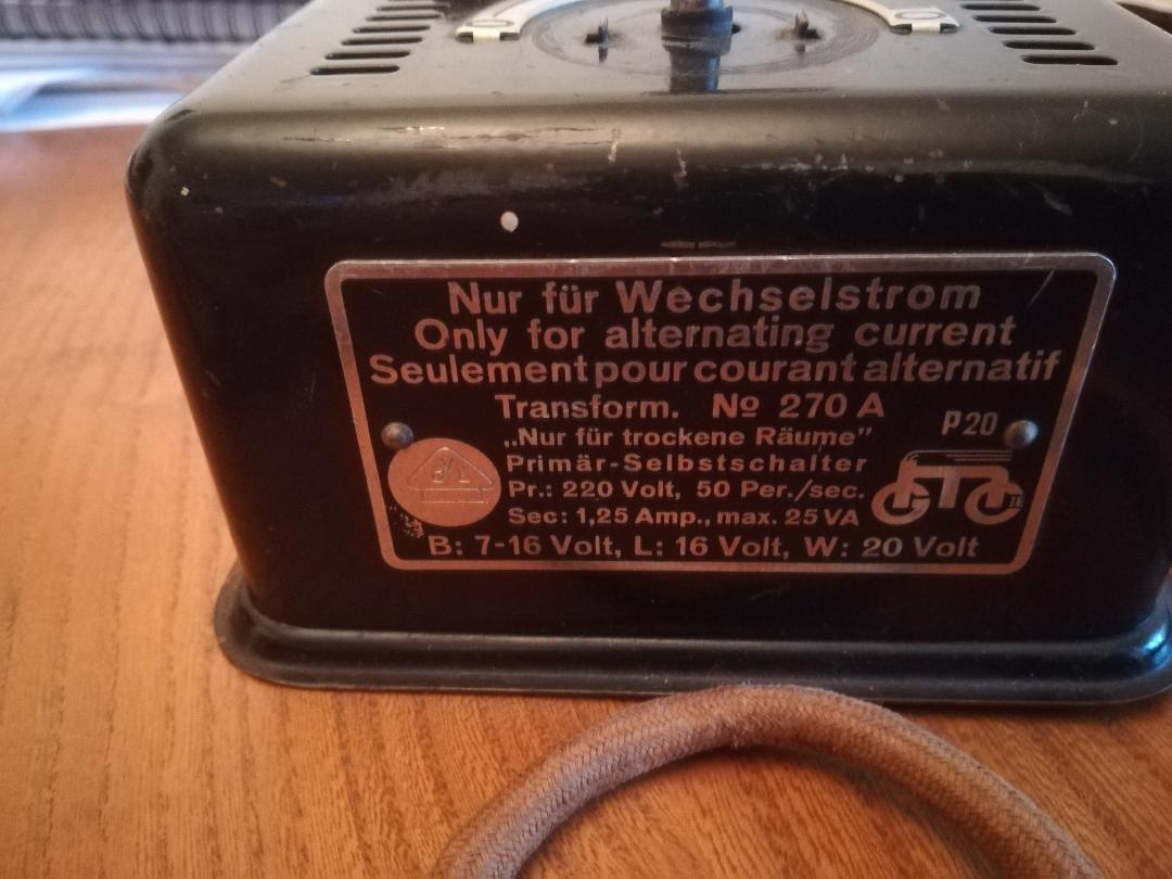

Thank you, I think you are right about the transformer. I'm not going to use it, for interest I attach a couple of photos. What would be really helpful is you could recommend a model of transformer which basically does the same job but that is easily available nowts6.jpg

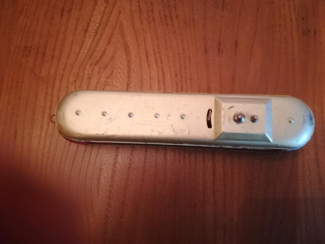

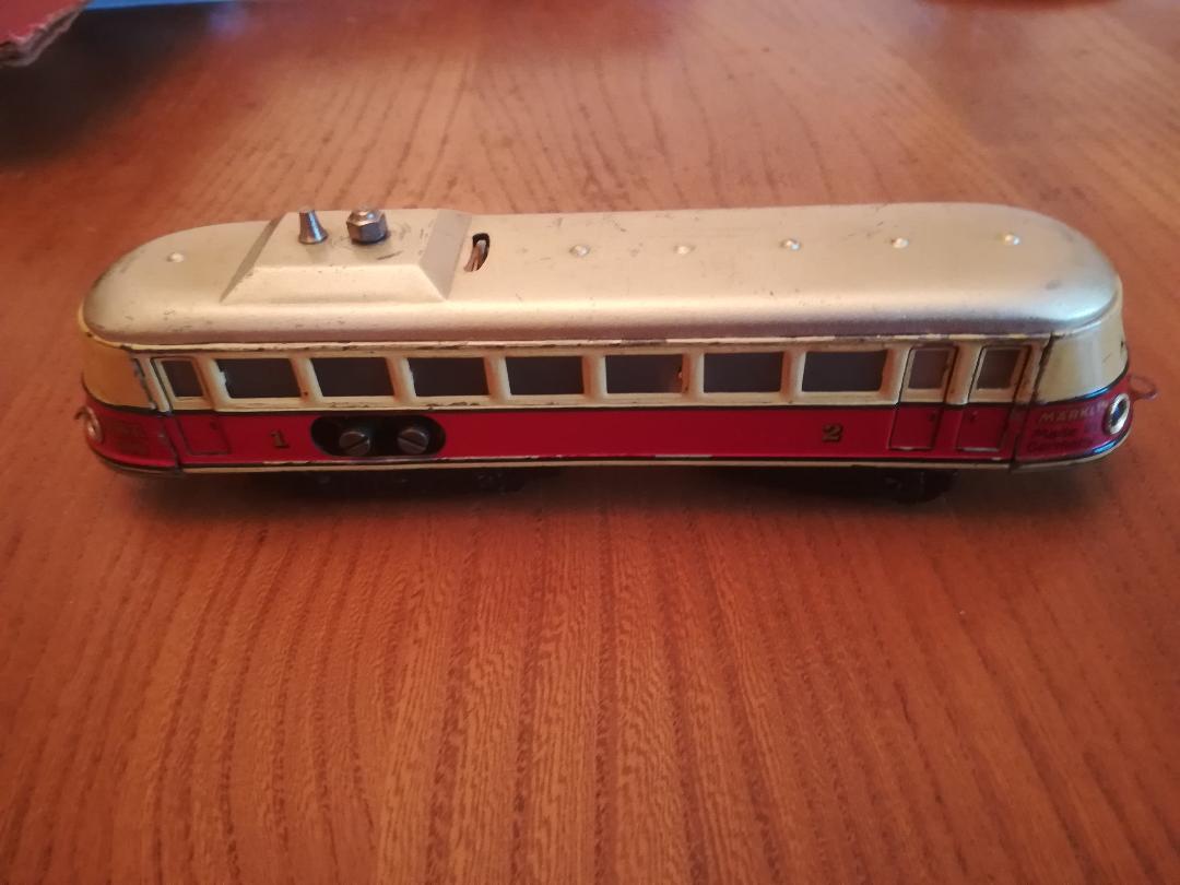

Thanks very much for your response. I'm afraid I didn't fully explain. I was given various pre-WW2 locos, pullman cars, rolling stock, track and points by my late father. So its really a collection of items. This track has a solid rail. I added to these items some new track (which has centre studs) and the 3000 loco in the mid 60s.
Yes I am very doubtful about the transformer and wont be using it, but would be interested in knowing what a suitable modern, available equivalent might be. I attach a few photos of the original pre 1945 stuff and the transformer.

Yup, I would keep well away from the black transformer, it predates metal blue ones and has a power wire that is cloth covered stuff that was once rubber!
Remember, when looking for a transformer to check that it is OK for UK voltage
For old 'analogue' use two numbers spring to mind, one is 6631 which is blue plastic and 6647 which is a significantly newer white one. Both 30VA. Others are available, you may only need a smaller one.
There are a couple of 6631 on Ebay UK at the moment, no idea about the vendors etc. They are quite heavy for postage.
