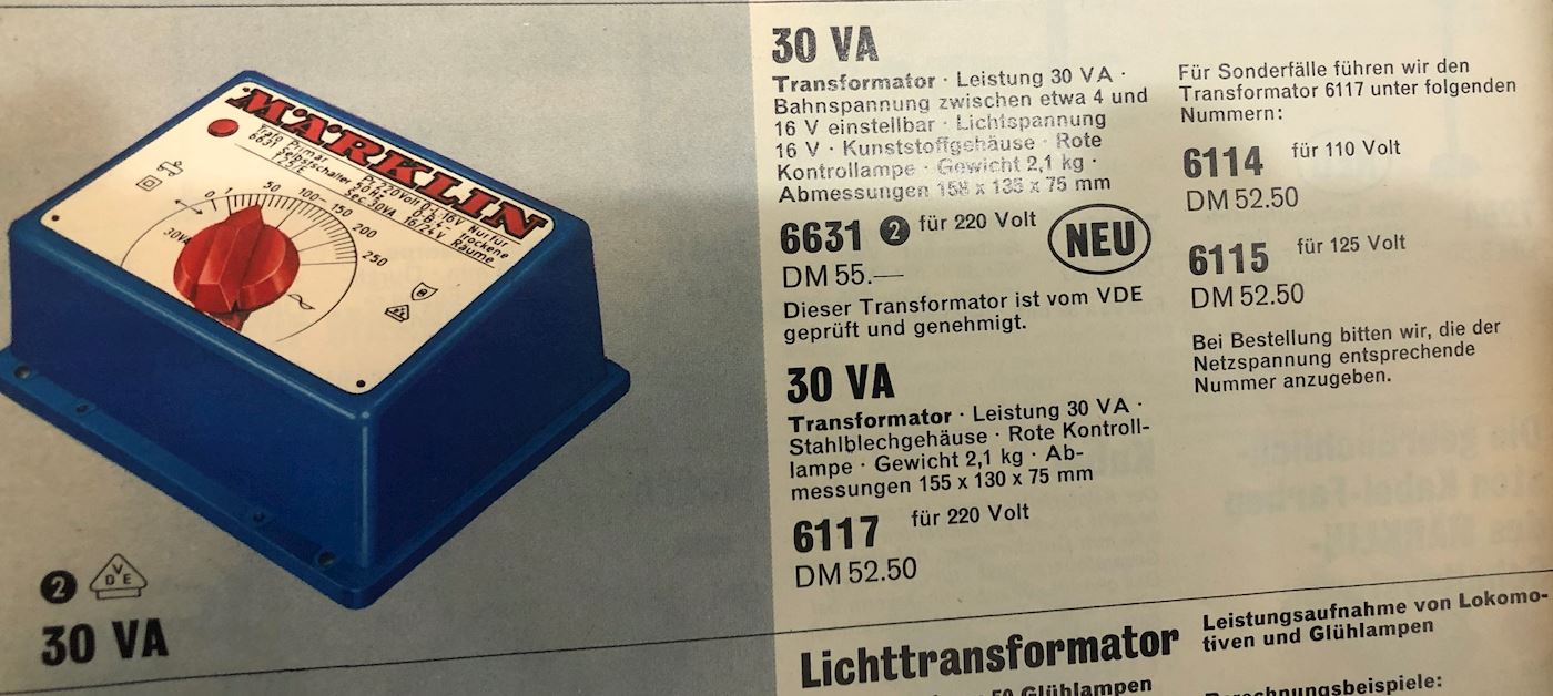

The 1972 catalog shows the 6114 as 110V, and the image shows 50hz. Hope that helps with the mystery; the German descriptions may also when translated.
Brian

The description from the 1972 catalog and picture indicate a plastic casing for the 6114 transformer. Evan's (bookcabinet) picture shows a metal casing so it must be an older version in the wrong box. The only way to be sure is to get the information off the back plate on the transformer - it will have the electrical details and the Marklin product number. 50 or 60 cycle doesn't matter for the motors and lights (unless your running an electric clock). I have three 6153 30VA transformers that state 50 to 60 cycle, 110 to 115VAC input and have never had any issues.
Harold.
