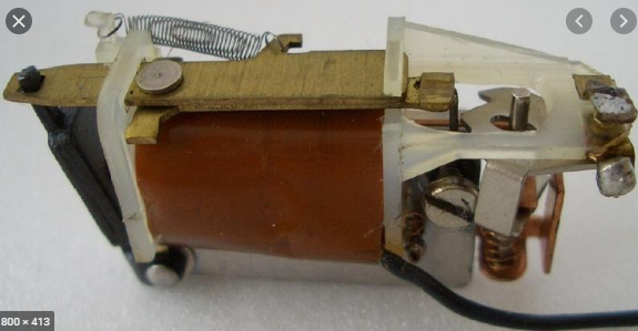

If yes, the direction change relay in the loco may look like this
Either you hear it switching, then check that no wires are in the way of the ratchet contact
Or the relay is not connected. Two wires: one is with the fixing screw (connects to the chassis) and the other one is connected to the slider (directly or indirectly depending on the loco

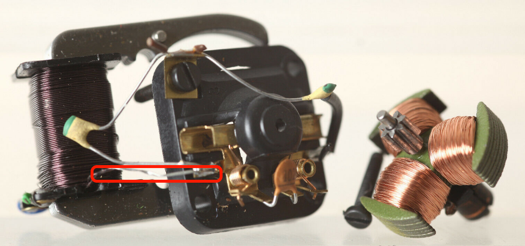

Either one of the relay wires going to the stator coil is broken (check the wires on the extreme right of the relay's picture
OR (happens a lot) one of the tiny wires going out of the coil to the closest brush-holder is brocken. This happens often after a motor cleaning See the zone in the red frame.
Please check which is which.

Your second message points to something different:
The relay is not activated but the switch and the motor work fine in both directions.
The relay coil has one connection by screen 2/3 on the right of picture below and another the black wire at bottom of picture.
Check for continuity, screw tight enough or broken wire again.
Those relays can be changed easily and cost in Europe approx 10€
