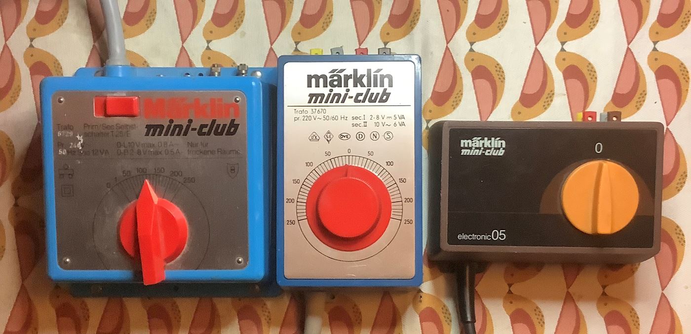

DB3127FB-CF54-4264-9A42-7E01762296C3.jpegI too have some of these white controllers with wall plug transformers but have never used them - they came in sets.
I use the old brown ones mostly and a couple of the blue ones. Only problem I have had is with one of the blue ones where the ‘push and release to trap the wire’ terminal for ‘b’ wouldn’t hold the wire. This was due to aging plastic inside the controller which allowed the back of the connector to be pushed back when the outside bit was pressed to put the wire in. That involved opening the controller and doing a repair with a piece of plastic cork from a wine bottle.

I am leaning towards getting some older mini-club transformers if I experience more failures, especially since my older ones (like the leftmost in your image) run great.
