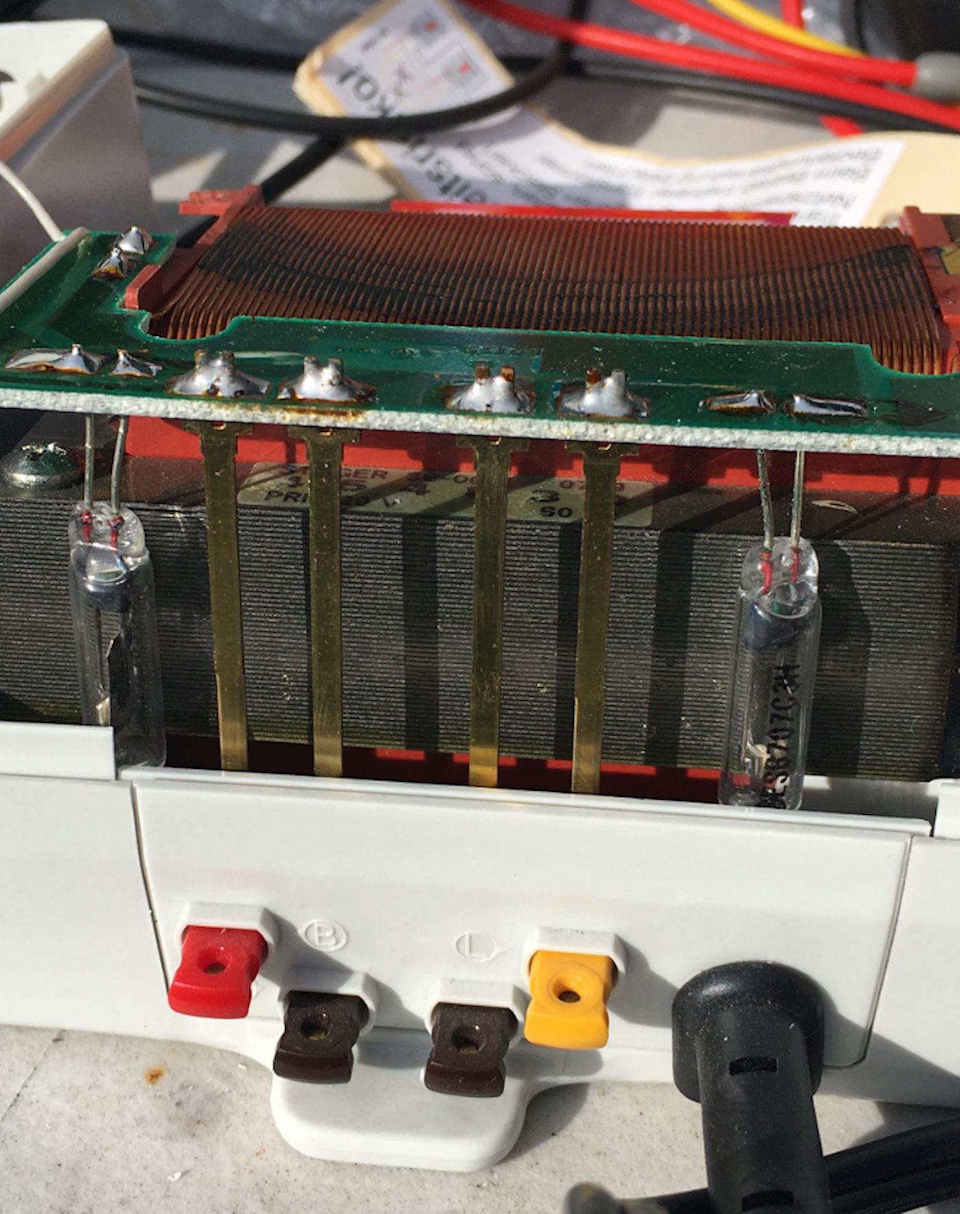

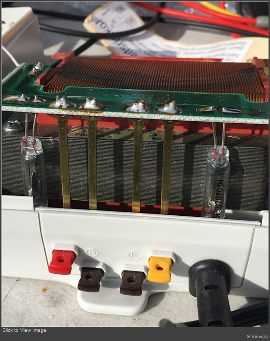

Here is the inside of a 6646 I just got off the Bay for under $40, both the fixed and variable outputs have very fast acting self resetting protection. This unit had intermittent dead spots on the variable output due to the dielectric grease the factory hooped all over the windings which had solidified. It works great now and for just slightly more than a decent hardware store doorbell transformer.
thanks 2 users liked this useful post by Studedude
#7 Posted : 13 March 2024 03:27:16(UTC)
Posts: 2,320
Super. Thanks. That makes it easy enough to build one’s own out of a doorbell transformer and some extra electronics since I only would need the fixed vac output.

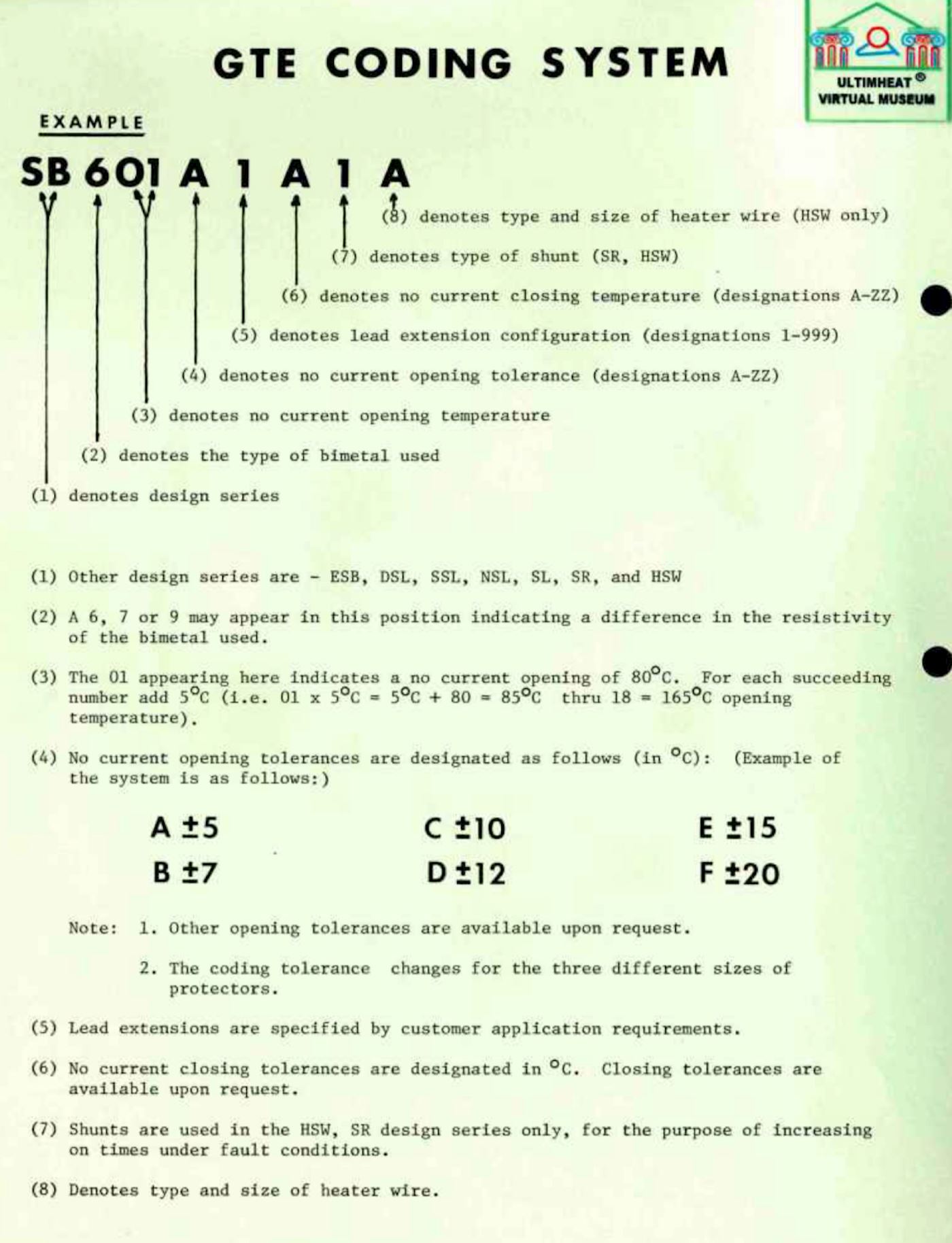

Now to find the modern equivalent of the older bimetallic temperature sensitive fuses.
ESB 707 3CH - opens at 105c
Can find some 100c ones easily enough.
The Sekicon ST22 on Amazon series looks promising.
