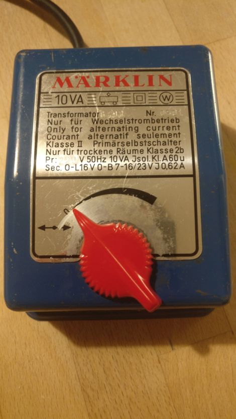

My transformer says 6496 nr 0501. So what is the case with this one? Actually not sure if it is metal or plastic.

a picture of it would help. Use the paper clip icon in the edit bar to attach it to your post.

Hi mwarsell,.... the difference between metal and plastic is very obvious. Just the feel and texture should give a clue, but if not, find a magnet.
If it sticks all over it's metal. If it does not stick, or maybe only in certain areas, it's plastic.
But as requested, a photo would tell a lot more
Here's a pic, hopefully it helps.
Thank you for all the help so far. Yeah, it's metal.

Here in NZ, we are ostensibly 230 / 240v @ 50 Hz, but our plug is quite different. Your existing Trafo looks to be a 220v version. You should be able find one for your specific country on your local Ebay or other auction site. Alternatively there is a good Facebook group for Märklin trades, as well as right here.
Regarding your existing Trafo, it dates from circa 1970 so it's not one of the really old-old ones. I believe it will have a safe PVC power cord rather than rubber (which is the one to really worry about).
It may actually still be quite safe, and if you know an electrician, or an appliance repair shop, they would be able to test it for you, and certify it if found to be safe. That may be cheaper than buying a new one? Something to consider anyway.
Note that it's only a 10VA which means it came with a starter set, fine for a single smaller Loco, small layout and maybe a light or two but that's about it. If your layout is larger, or you want to operate electric turnouts or other accessories, or have lighted coaches, then you'll likely need a higher capacity Trafo.
If you are decided to replace it, you should really aim for at least 32VA going forward.
