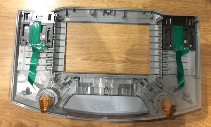

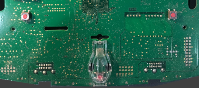

On the mother board there is another plastic part to interface with the surface-mounted device switch Here it is (part view of a 60215 motherborad rear side)
NOTE: Märklin will NOT sell any inside spare part so either you repare it (glue broken plastic part, replace the SMD switch if falty with proper SMD soldering station (hot regulated temperature air) or you send it to repair in Germany.
Not quite true. I managed to break the clear plastic part in the above photo, on one of my cs2 units. I took a photo of the broken part and sent an email with the photo attached to marklin service, saying I found my stop bar didn't work and this is the reason. They wanted me to send the whole cs2 back for repair, but i protested that the fault was obvious and I didn't see a need to go to that expense. They eventually sent me the plastic piece gratis.
