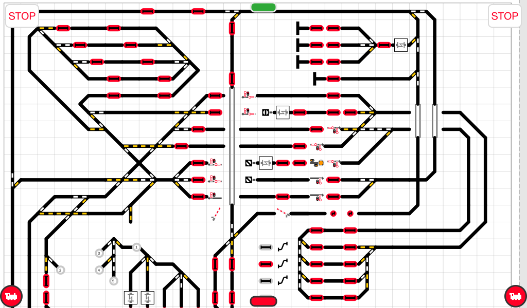

I just had to move from a 60215 operation to a 60226 since Christmas 2020.
The quickest IMO is to redo everything. Yes I has backup but there was so much changes (track display, S88 / L88 sensor scanning) that is was a good opportunity to clean.
In my case I had to migrate all sensors which were connected to the CS2 and make the transfer to an existing Link88
I also used the new synoptic track plan which goes like this

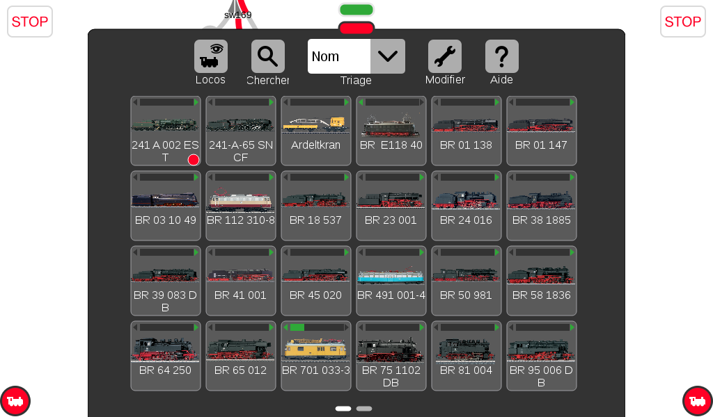

The registration of all my MFX locos (36) was a bit painful as the CS3 could not register the trains from their location so I had to do it by groups of 5 locos
Since I am using Rocrail I had to check connections and configuration but it went smoothly there.
Good luck
