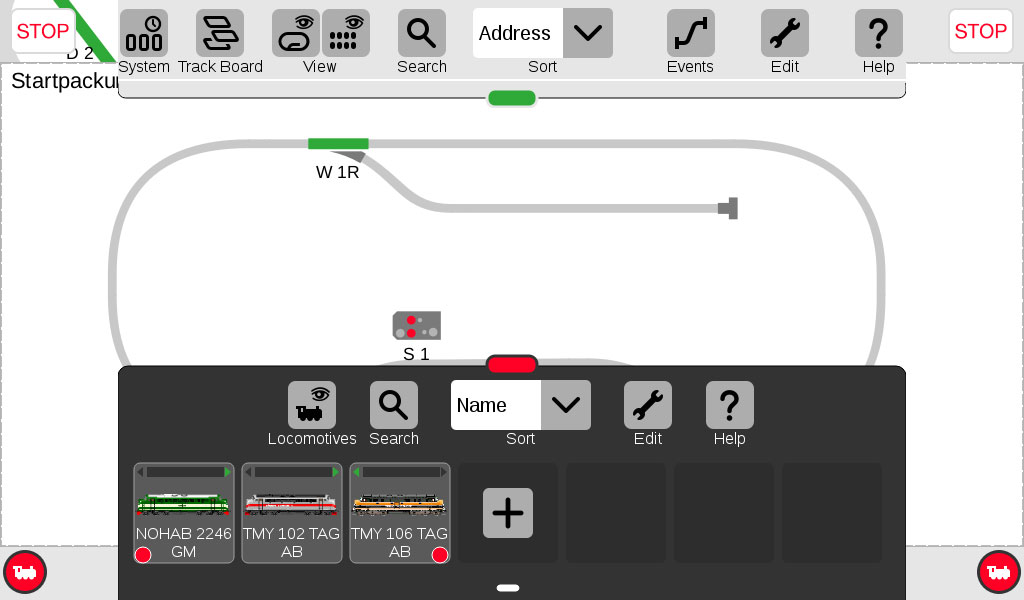

I updated my recently bought CS3+.
Now the software version is displayed as BETA 1.1.0. Is it the most recent update available ?
Thank you, Francois.
Offline fhp2
#28 Posted : 07 November 2016 10:05:37(UTC)
fhp2
Joined: 11/11/2011(UTC)
Posts: 86
Location: paris
Me again...
I also imported my CS2 backup file. It looks ok but the TCO background is now purple so it is impossible to see the tracks between turnouts...
And if I want to create a new layout, the background is still purple/pink... I did not find a way to choose any options concerning the layout design (colors etc...).
Thank you for your help,
Francois.

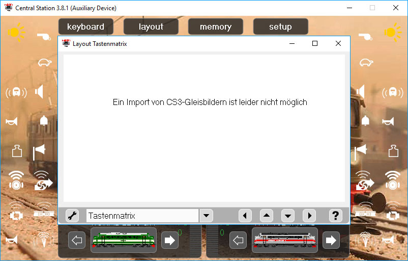

I have managed to make backups from CS3 Plus and I have also updated my new device using both manners mentioned in this thread( using red buttons first right button+STOP and after updating was ready then left red button+STOP).
I don't know where you have learn to use this kind of updating? would you kindly tell us all please.
I cannot see any mention that in my device might be some beta-versionBlushing can you tell us more about it.
Then I have tried to transfer data from my old CS2 (60215) using several different USB sticks but I have no managed at all.
I can see from the USB-stick that I have managed to save CS2 backup there but when I put that stick to my CS3 Plus I can see the right stick there, but my CS3 Plus don't read from there anything( I can sii it from the led on the stick).
Please if someone has succeeded in this task tell us how you did it.
I realize that some of you might have insider information about CS3 and CS3 Plus.
Please share your knowledge to all of us
Jukka

Originally Posted by: fhp2 Go to Quoted Post
Me again...
Francois.
Hi Francois!.BigGrin
Could you tell us exactly and step by step, how did you manage to imported CS2's backup-file to CS3, I have tried it by all possible( well as I have known) ways and no succeed.
My studies of CS3have been interrupted to the fact That I do not get CS2-information into CS3 device. Blushing
I would be grateful for the assistanceThumpUp ThumpUp
Jukka

I don't have my CS3+ in front of me, but if I remember well from last Saturday, I first updated the CS3+.
After this I had software version BETA 1.1.0.
Then I backed up my CS2 on a USB stick.
I plugged the stick in one of the 2 USB connectors (not the powered one), then I clicked on the Settings icon, then the CS3 icon and I chose Restore.
From there, I clicked USB then I chose my backup file and that was it...
thanks 1 user liked this useful post by fhp2

Well, on the settings tab, in the right upper corner I had an icon (a square with a little arrow going in) meaning that updates were available.
So, I clicked that icon and it started the update process...
By the way, in the CS3+ section of the Settings tab, you have to tick the "check for update" option (not sure of the name...).
Offline fhp2
#35 Posted : 08 November 2016 14:41:33(UTC)
fhp2
Posts: 86
Location: paris
You can also push the left big red button at the same time with the Stop bar for the normal update....
For the GFP update, you push the right big red button with the Stop bar.
I have done this ( above) and got purple screen on which I can find all my boards I have done before and also there are all magnetic items to be found.
Like you I would say that it is difficult to see route from purple screen.
At that point I looked INFO:
Then if I start to update with left red button all went ok and purple color has gone.
After that I looked INFO:
Here we are again, BETA-version is gone and UPDATE from CS2 don't succeed.
I tried also update from CS2 when the screen was purple and result was:
But I couldn't get anything from my CS2 update-file from USB-stick.
Mysterious isn't it.
I have sent a question to Märklin Service and we will see ( perhaps much later) what is the situation of CS3 Plus at that moment.
If someone else had succeeded to update some data from CS2 please tell us how you managed to do it and most important question is:
How log it take to load CS2 stuff from USB to CS3 Plus or CS3.
Hope you all the best
Jukka

Offline siroljuk
#38 Posted : 08 November 2016 16:38:45(UTC)
siroljuk
Joined: 29/10/2010(UTC)
Posts: 377
Yes just so.
But I didn't see any item from CS2 when purple screen was on. Just that Information that there should be update from CS2 succeed.
I cannot understandBlushing
But anyway, I don't give up.
Tomorrow I will try again and again in different order to make updates and from CS2-import.
I have the functional environment of CS3 Plus backed up in the memory card.
The solution might be so that I have to try several USB-sticks with which to try to make that file transfer from CS2.
Sofar, the best advice is not to attempt to do this, as you could brick your CS3. Apparently we have to wait until Marklin tell us it is safe to do this and they release an update for it.
https://www.marklin-user...rting-CS2-datas-into-CS3
