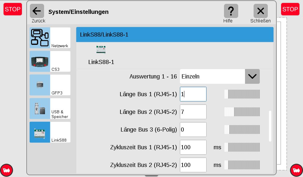

I have successfully added 6 S88s on my layout. The 7th and final S88 will not work. I can not get my reed switch to signal the CS3.
I have the correct " length" on my CS3 for the GPF-3
I have switched RJ45 cables to see if there was a bad cable. I bought an extra S88 thinking the last one was bad but I get the same result.
I have seen glitches in the CS3 before, but this one is making me crazy,
I have seen people try a reboot and change the length back to one etc.
I could really use some ideas to fix this issue. I only have 15 more reed switches to connect.
Thank you in advance.
#2 Posted : 28 July 2021 17:59:18(UTC)
Posts: 3,692
Hi Eurotrain (funny kinda first name I think)
My guess your problem is you have to specify the length of each bus (1, 2 and 3) on your CS3 or the Bus 1 on CS3+
On my CS3 is shows like this with one S88 on Bus 1 and 7 on Bus 2.
If you have a CS3+ there must be a similar screen with only one bus
Failure to indicate the proper length means the extra modules won't be scanned (will not report information back)
