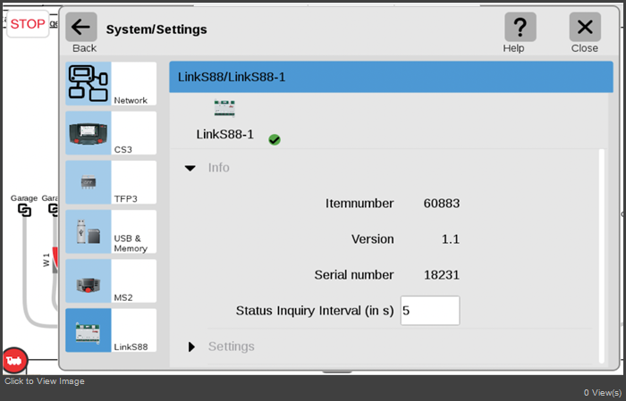

I currently have 10 contacts working on my S88Link and I have been trying to add 4 more. Every time I try to add them they do not work. Even testing them at the terminals does not work. The previous 10 contacts work fine at the terminals and the track, but the 4 new contacts do not. Am I missing something?
Here are some screenshots of my set up.
Here is how I have the new contacts, 11-14, set up.
Here are the settings of the S88Link.
Every time I restart the CS3 my track board shows the 4 new contacts illuminated.
Also, I have 1 S88AC connected to the S88Link. That S88AC has 11 contacts which all work fine. Any help would be appreciated.

I think I've solved it. I think the S88 contact wires were to close to the power feed wires. I taped up the power feed wires with metal HVAC tape and everything works fine now.
