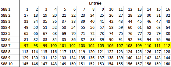

When you connect a M88 or S88 to a CS2, using the flat cable connector from under the CS2 all units are self numbered depending on the order you connect them to the CS2
- first unit (connected directly to the CS2) has the addresses 1 to 16
- second unit 17 to 32
- third unit 33 to 48
- etc
So it is convenient BUT you cannot insert a unit between other without changing all the units downstream.
Here is a small table to help you with input numbers for the CS2 or CS3
Each line represents one S88 or M88 with 16 inputs
So for the seventh unit (S88), the zone in yellow, shows you the addresses of its inputs 1 to 16

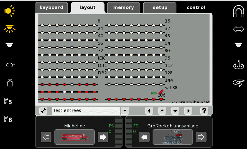

This is the reason why I selected to have a Link 88 with 2 busses going in different directions
There the addressing is a bit more complicated
- inputs 1 to 16 of the lik88 have the addresses 1 to 16
- inputs 1 to 16 of the first module on Bus 1 have the addresses 1001 to 1016
- inputs 1 to 16 of the second module on Bus 1 have the addresses 1017 to 1032
- inputs 1 to 16 of the first module on Bus 2 have the addresses 2001 to 2016
For the tests, it is best to create a testing table
It goes like this
Note the bottom of the screen where a Link 88 is combined with old 6088 modules with flat cables (daisy chain) originating from the CS2 bottom.
