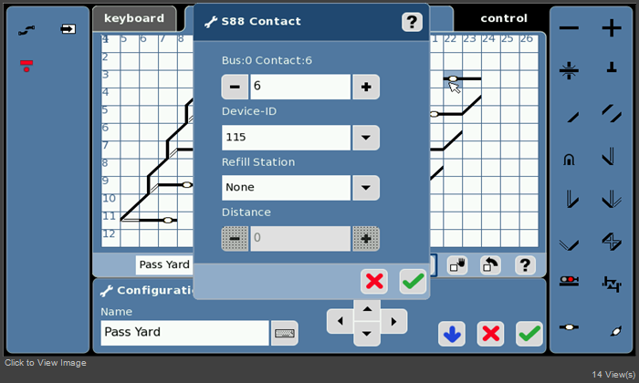

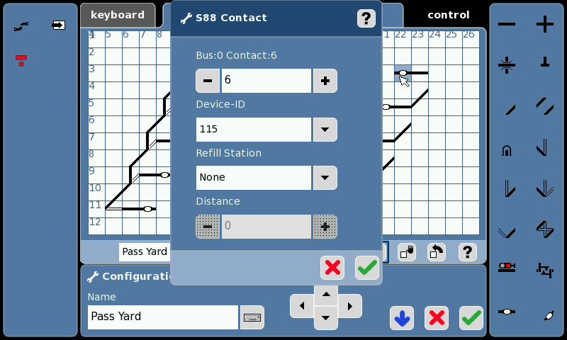

First, this is the dump when I did the http/IP address/config/geraete.cs2. No idea what this information is ipaddress_config_ geraete.cs2.txt (2kb) downloaded 30 time(s).
Next is a picture of the dot assigned to address 6 from the layout screen

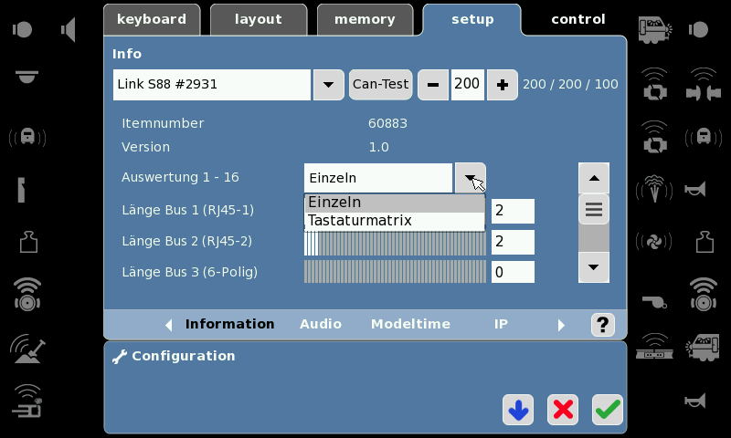

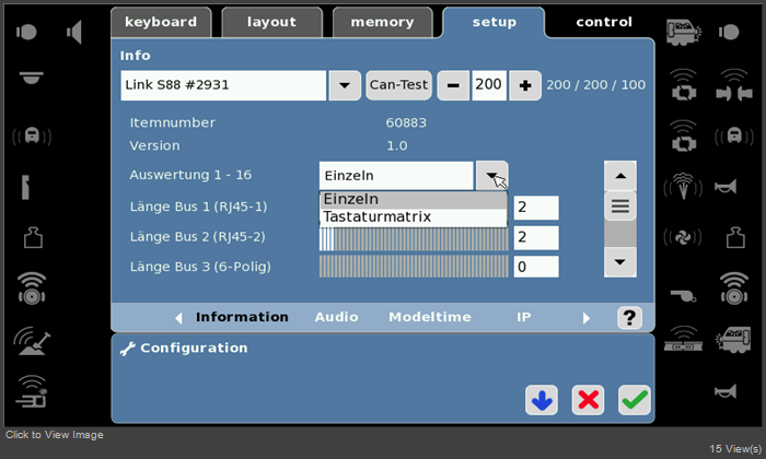

Not sure what and where 'Mode of L88(matrix or single)' is. Following are screen shots from the set up configuration screen related to the L88
This last picture may contain the matrix/single screen shot you requested.

Not shown in the images, but noted in the config file, is that you have the L88 set up for 8 rows and 8 columns. As though it was for matrix mode even though the main option is set for "Einzein".
I concede I have yet to fully understand the interaction here, HOWEVER getting things out out sync can definitely cause (confusing) symptoms. It may be just in the order things are done or whether CS2 assumes.infers incorrectly
My current theory is that the Einzein/Tastaturmatrix is no longer being used and if the row/columns fields are set to 0 it = no-matrix mode but if they have non zero values, matrix is implied
Please
- Set both the column and row values to 0
- Save
- Restart CS2
- Check config that the settings have stuck.
- Retest (jumpering a wire from "T" to "6" on the L88)

On the same screen you have shown Information->Setup->L88 - Scroll right to the bottom
In my read of the manual,, pg 22, I should have the setting on matrix and the memory settings use address like 6 or 2001, etc. While that is consistent with my current approach in Memory), these pages are not clear - seems it's for the 72720 when connected to the L88.
No.
You may set the L88s native ports to EITHER single mode or matrix mode.
The issue I am pursuing is to make sure you are consistent with your mode setting and the Column/Row setup.
i.e. in Single mode the Row/Column values should be set to 0
IF you choose Single mode, then there are 16 ports that are used in exactly the same way as a traditional S88. i.e. 16 ports that have a return circuit to the "T"
In this mode the addresses are 1 to 16
IF you choose Matrix mode then you use some of the ports as (usually 8) as rows and the remainder (usually 8) as columns.
in this mode you do not use the "T" port.
64 addresses are possible and these are fixed at address 101 to 160.

For my shuttle, I am using 2299 (k Circuit track). I have a wire connected to contact F9 and G1 (on the S88s) but no other wire. I have 3 loop wires (1 for freight service, 1 for passenger service, 1 for auxiliary items). I understand your comment to mean that I should attach a (brown) wire from the track to the T on the L88 (or any S88). Correct?
Harvey
Offline clapcott
#17 Posted : 12 February 2019 04:40:32(UTC)
clapcott
Joined: 12/12/2005(UTC)
Posts: 2,464
Yes
I have 1 L88 and to it I have connected 2 S88 to Bus1 and 2 S88 to Bus 2. The memory address blocks are
L88 A,B
Bus 1 C,D,E,F
Bus 2 G,H,I,J
Port F9 would be 115:1025
Port G1 would be 115:2001
fwiw. the shuttle configuration file is http://x.x.x.x/config/pendelzug.cs2
