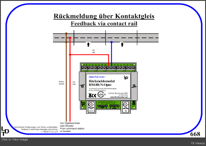

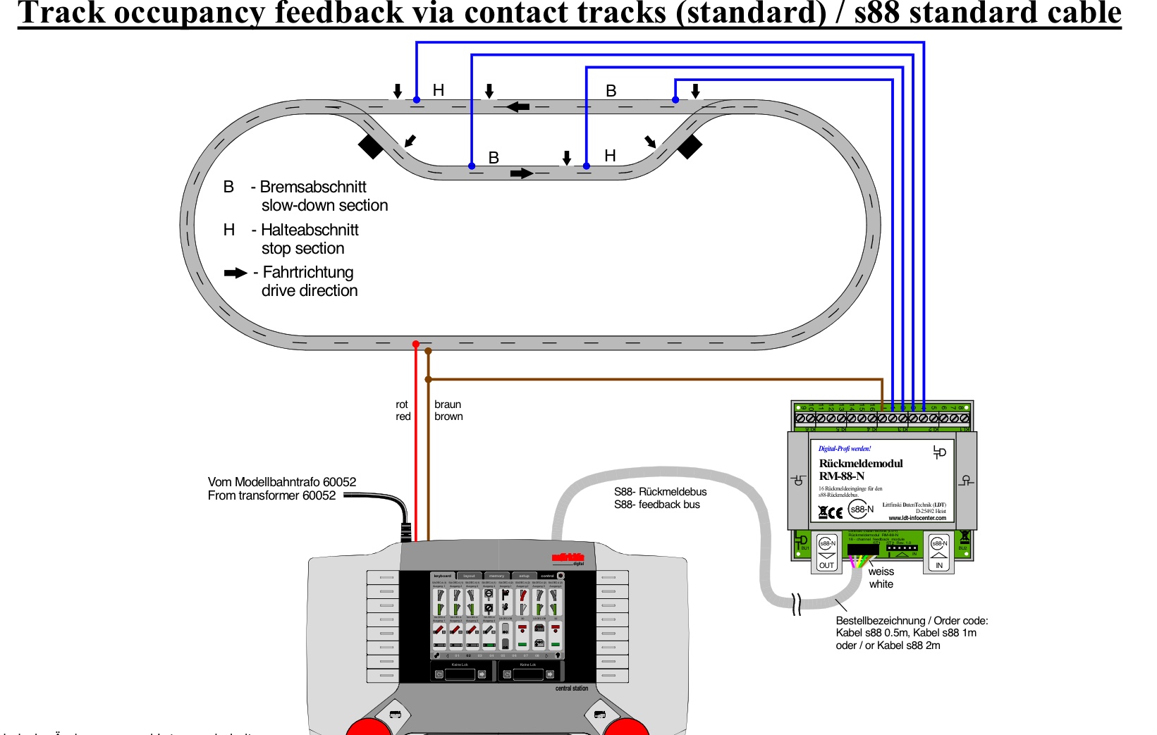

Is your LDT module connected as follows?
Are your modules connected via ethernet/patch cable, or via standard S88 cable? It could make sense to try the more reliable ethernet/patch cable variant. To connect the modules to CS2, you need the following items from https://tams-online.de:
1 x S88-15 (Short 15 cm Wire)
1 x S88-A-SL (Adapter)
Offline PeFu

It doesn't matter whether it is a LDT or Maerklin S88 decoder, the first S88 decoder in the chain needs to have the reference wire connected to the T terminal/port.
Actually, wiring could be different depending on module type, see below:
Using these modules, wiring is the same no matter if it’s the first or last module in the chain.

True. If it is a LDT Opto version you need to connect the B (red) to the T terminal. However, he had already replied that it was the standard LDT RM-88-N version, not the Opto, so the O wire connection is the correct connection for either the Maerklin or LDT decoder.
The point I am trying to make is that you need to connect the appropriate wire (whether O or B) to the T port/terminal usually at the first decoder module regardless of the manufacturer. You cannot leave it disconnected and expect the S88 to work correctly.
No he didn’t, and that’s why I asked the question of LDT model... Blushing
However, it seems like we have the same view on how the S88’s should be connected, and that is the only real important thing here. Cool
But I don’t understand how the setup can have worked, without the ”T” connection?
