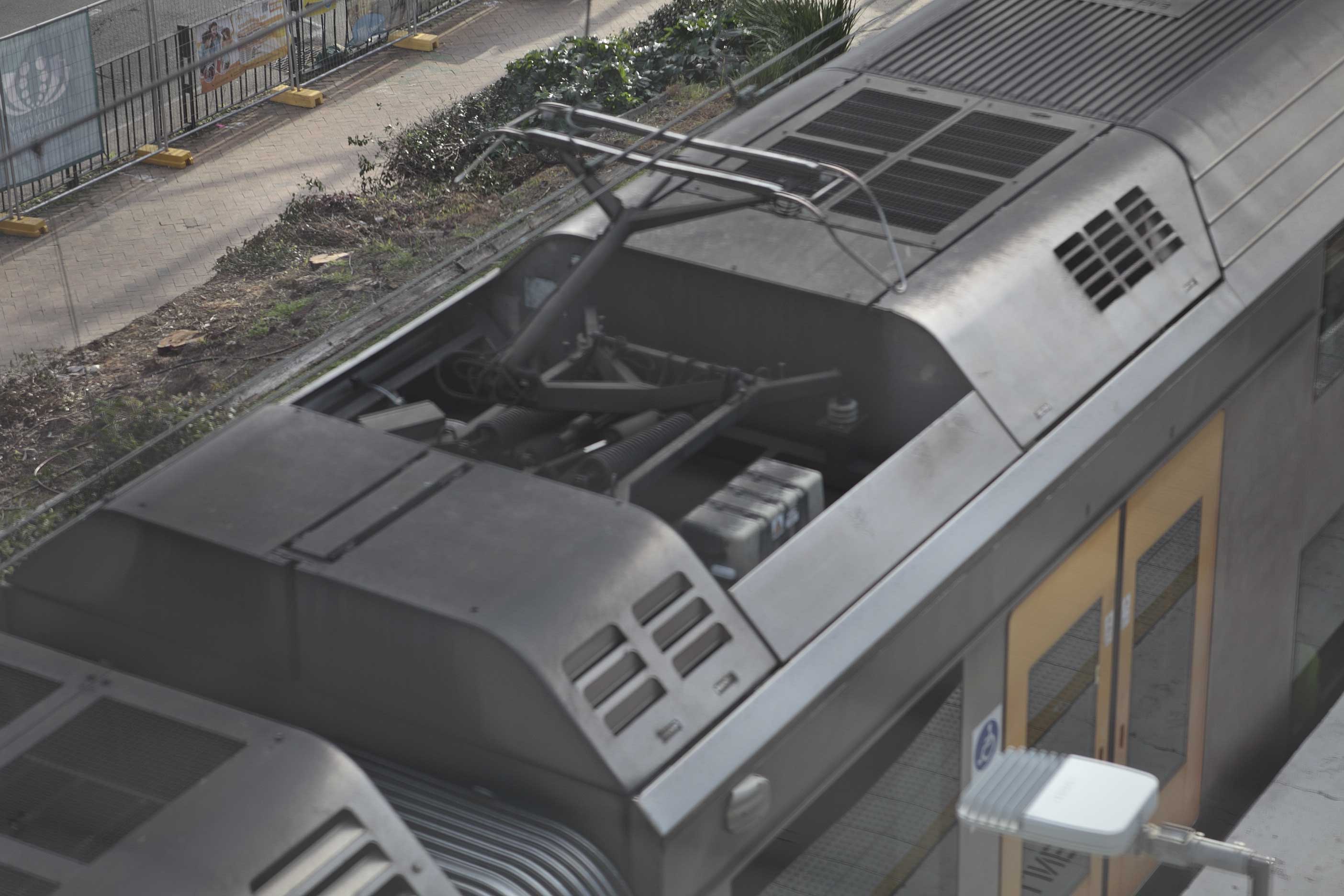

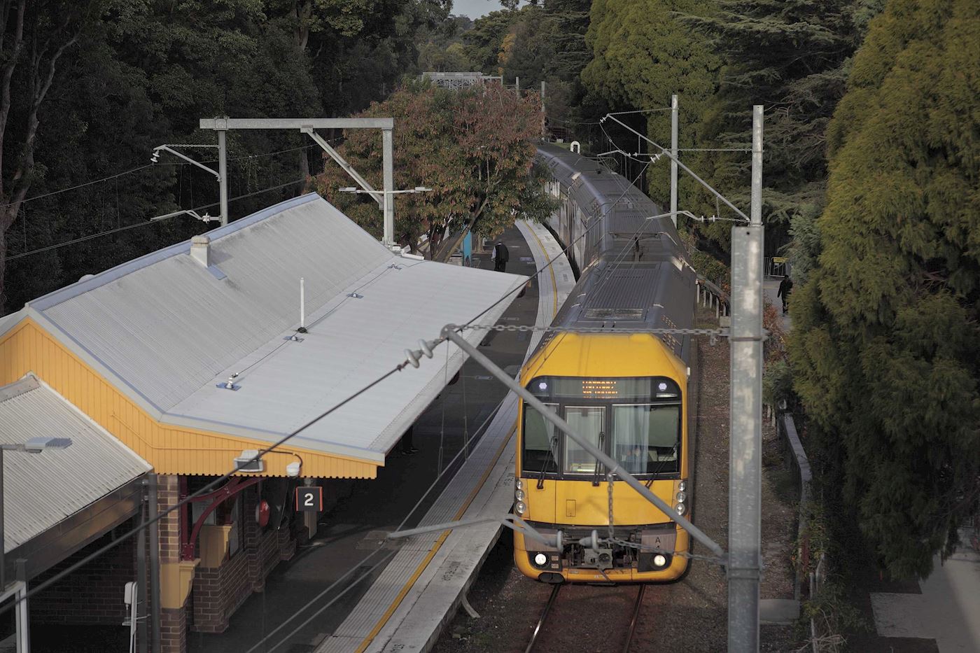

A couple of photos I took at Artarmon station Sydney. The 4 pantographs are used (shot through very dence wire fencing also above head).

Probably the answer is: The train will use as many pantographs as needed to power all the blocks.

Not only are the Sydney trains using 4 pantographs. There are dual wires.
