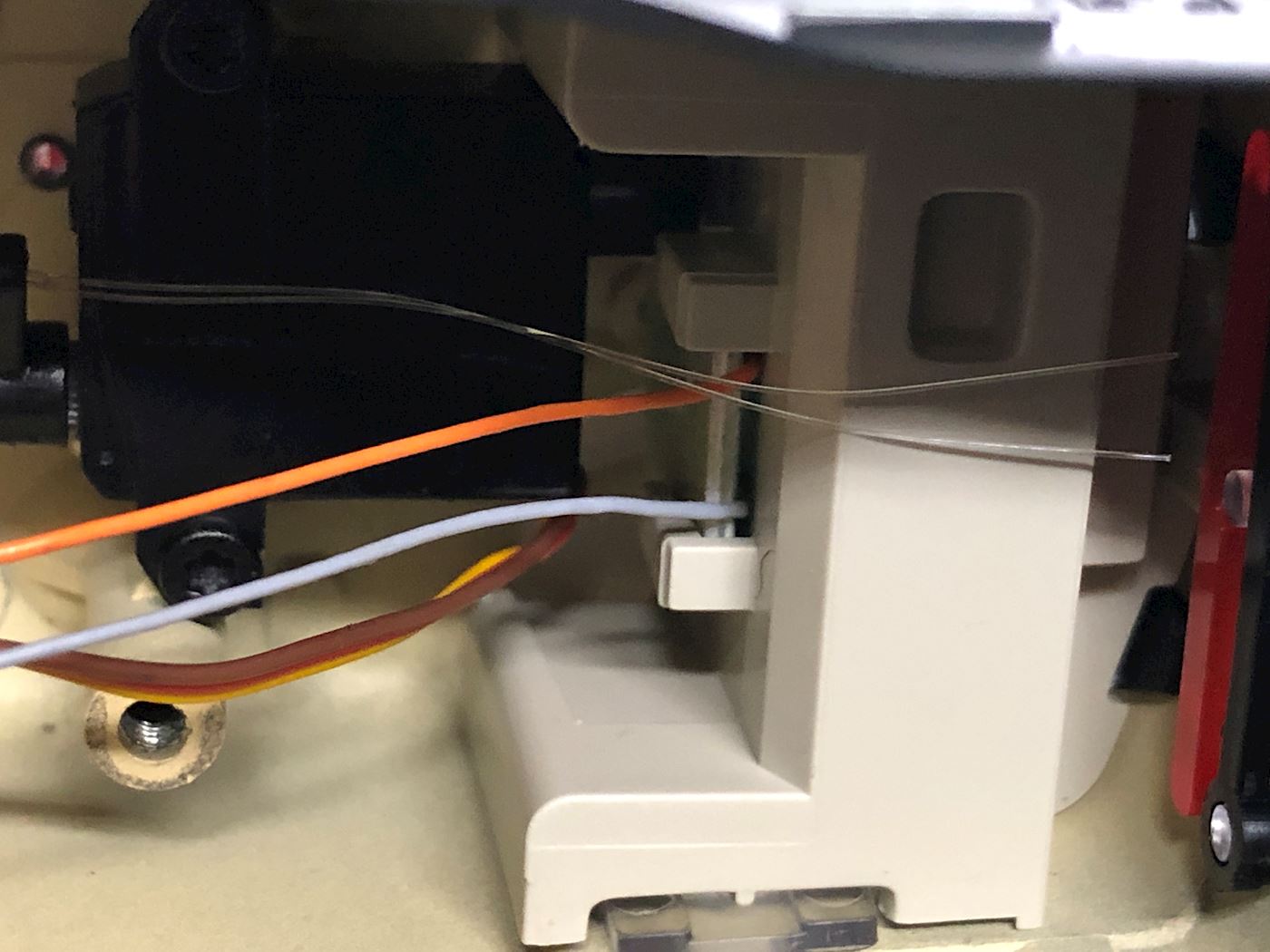

Thomas,
Did you open the loco and have a look?
Maybe something got out of place during the 20,000 km journey.

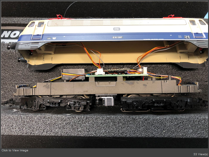

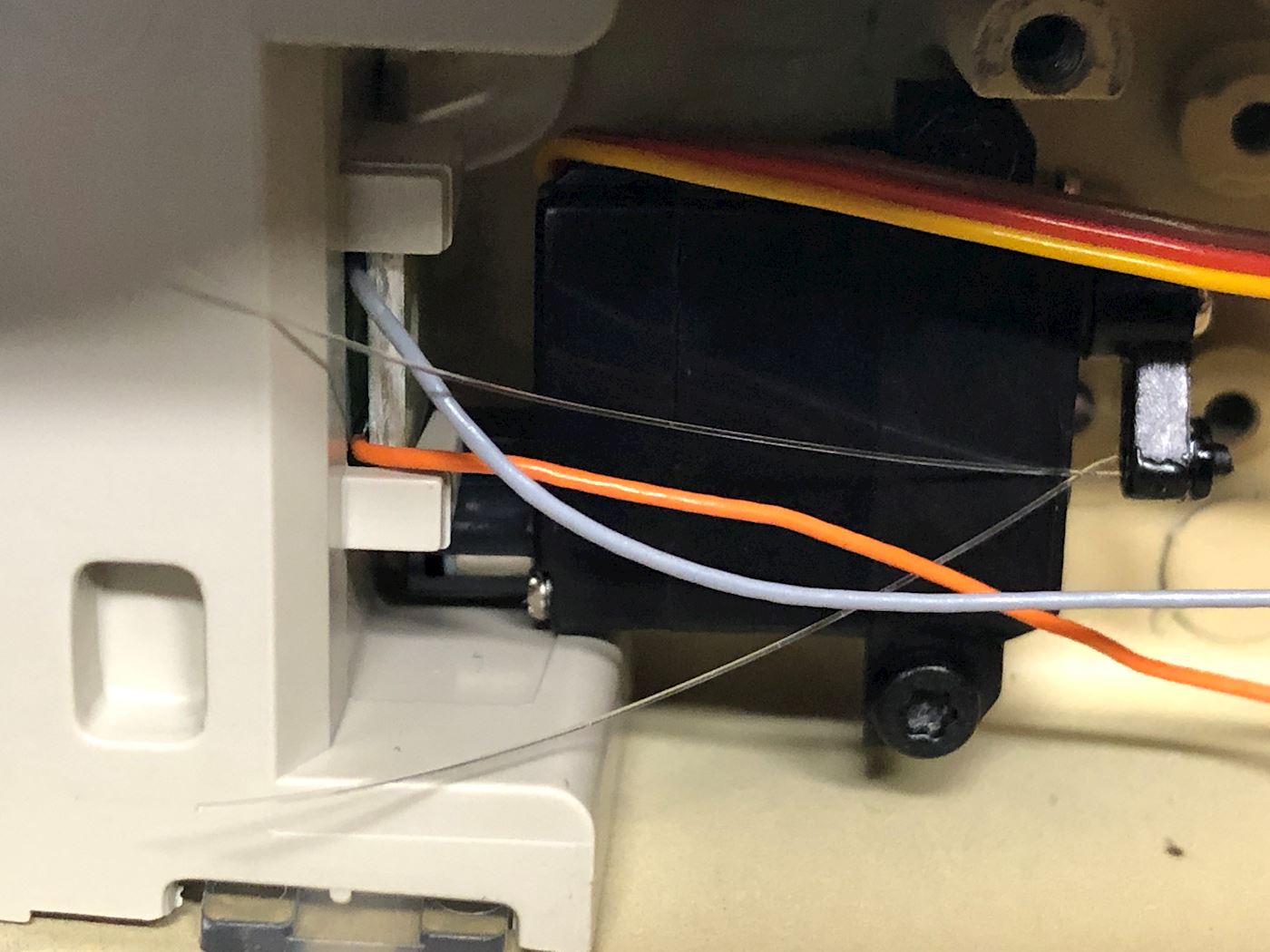

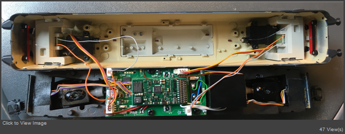

I just checked the manual: it seems there are permanent wire connections between loco board and body. So do not look for bent springs, but look for loose wires or wires that have been squeezed between body and frame.
Yes, I did open it up and the wiring looks ok.
Fortunately Märklin did not solder the wires in place. They have nice connectors.
Looking at the servo's they have the expected 3 wires going to them.
Then there are two super thin silver/white lines going nowhere.
They look like they originate from the servo arm, on both sides Confused . Any idea what they are?
I connected the engine up while open and issues the panto's up/down command from the CS3.
No movement anywhere, (especially on what looks like the servo arm) but the sounds were playing.
I'll be in Europe next month, so a visit to the dealer is one of the next steps.
Thomas
#10 Posted : 25 June 2022 01:36:44(UTC)
Posts: 4,060
Ah, you'd added the photos while I was posting my comment.

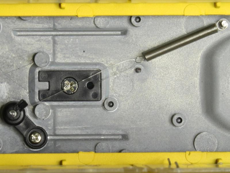

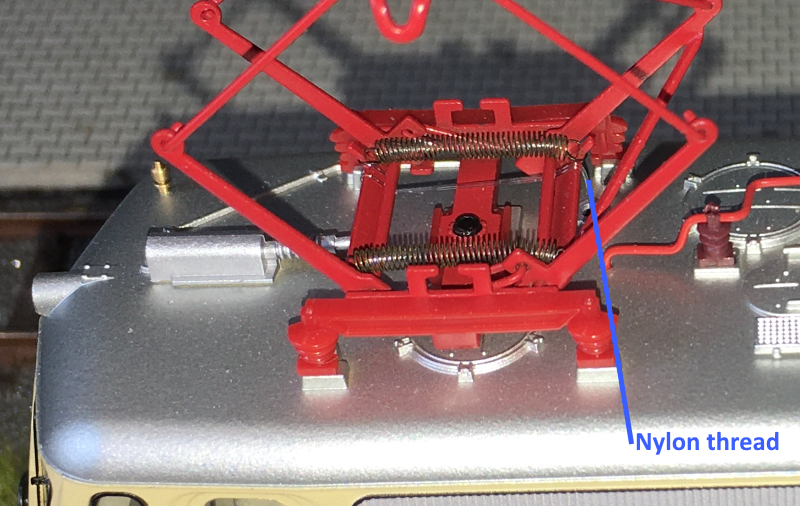

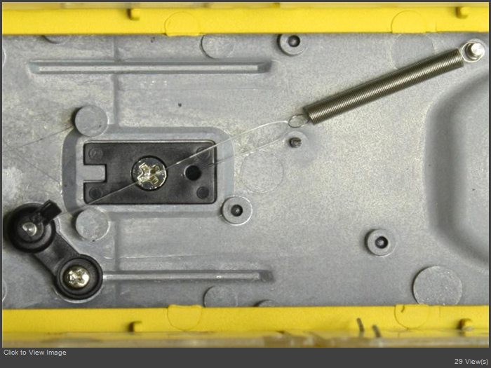

I believe the disconnected nylon threads may be the issue. Is there a small hole above the servo arm where those could go up through the roof and attach to the Panto?
On my one, the thread is relaxed allowing the Panto to raise, and the thread pulls it back down. For transport, the Panto is meant to be in the raised position, and then lowered by hand. There's a spring that the thread goes through to take up the slack. Kind hard to explain but I'm not sure your model uses the same design.
Possibly there are two threads one to raise and one to lower but that's just a guess.
I see you are heading back to Europe so hand-delivery seems the best option. A good dealer should just swap it out if he has stock and then he can deal with the repair. Probably still be helpful to him to know to expect you.
Are there any notes in the instructions about how to prepare the Pantos for packing/shipping?
This is how the thread looks in mine - note the 'motor' is on the chassis, the cam for the panto is mounted in the body and engages when reassembled (photo courtesy Ross Stewart Australia)
Hi Stephen, I was going to go "Snap!" as well :-)
Agreed, they missed the install of these threads, probably also the setup of the servos and I will let the "dealer" "deal" with it. BigGrin
How that passed the "Ausgangs Qualitätssicherung" at Märklin, I will not speculate on.
There are 2 relevant points in the instructions:
  • extend the pantographs before locking them in place when packing the engine. Which is consistent with your description of the thread lowering the panto.
  • The pantos on this model are not repairable except in the service center. Which means I will leave my fingers off that, given a perfectly good warranty
Thanks for the video link on the piezo engine and the snapshot from Ross above. Paints the picture.
And yes, the dealer in Austria got a 132MB video of what did not work immediately after the unboxing and are expecting a return/visit. No problems with them.
Mistakes and faults happen. It is still a nice model.
Cheers Thomas

Those two thin transparent plastic is to connect the pantograph!!!
Talk about bad service by Märklin staff!!!

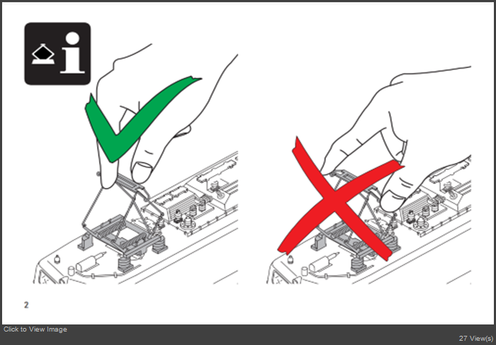

Hi Thomas
I have this great model and it is working like a charm BUT in the users manual, it says YOU MUST unlock the pantographs before first use.
If you didn't no harm is done but it won't work.
DANGER: If they are already unlocked but maintained low by the (servo I guess) then you may damage it. So be careful and position them up (by digital command) before unlocking them.
Page 2 of manual shows how to avoid lifting the pantograph by its extremities
Page 3 of manual says:
Note: Before running the locomotive for the first time, the
pantographs must be unlocked by hand. The pantograph
flexes upwards on its own in the upper position.
When packing the locomotive, always make sure that the
pantographs have been raised electronically and then you
can lower them by hand and lock them in place.
PS I am glad Märklin stopped using piezo motors (10 years ago I think). I have 6 of them on the Turmtriebwagen and on the former Ardelt crane and at least 2 of them are not working good. Issue: rapid wear on the aluminum nose.
My 2 cents worth

Did you even noticed his pictures inside of the locomotive?
There is transparent plastic wire that are not retrofitted to the pantographs!!

So, no movement at all from the servos?
Could the loose transparent plastic wire ends be the unused ends not being cut, and thus the wires are actualy mounted to both servo arms and pantographs? I can't tell from your pictures.
I don't find it logical to have two faults - servos AND connections to servos.
My 2 cents worth

You mentioned a nylon wire to the pantograph. Indeed in the previous design, there was a thin (0.10 mm) nylon wire to pull down the pantograph (like on my 39970 Turmtriebwagen -catenary inspection car). On this new 39126 loco, I didn't see any but my sight is not that greatCursing
As soon as I get near my loco I will make pictures for you. A week maybe.
#18 Posted : 03 July 2022 01:44:48(UTC)
Posts: 3,687
Hi Thomas
As promised here is the picture of my loco
I opened the loco just for you.
I realized that indeed, there is a nylon thread but very nicely concealed (Vertical at the base of the pnatograph)
See below
I hope this helps
Warning: when re-installing the case on the chassis, make sure no wire gets tangled in the fixing screws
Jen
#19 Posted : 03 July 2022 09:01:33(UTC)
Posts: 3,540
I realized that indeed, there is a nylon thread but very nicely concealed (Vertical at the base of the pantograph)
As I see your picture, the un-used ends of the nylon thread are hanging loose inside the loco - thus not being an error, as I suggested earlier Blink

Hi Thomas
I hope this helps
Jen
It`s very interested that Märklin didn´t add extra PCB under the roof for the pantograph and lighting.
All those wires don´t make sense when you try to close the body again on the frame.
Is that´s way this locomotive model are cheaper than others?
It looks mess for me.
#21 Posted : 03 July 2022 13:33:07(UTC)
Posts: 8,618
Goofy,
I think this is a case of economics, why have another PCB to connect those wires to, then have a wire run down to the existing PCB? That becomes two extra items to manufacture and inventory, when the wires can go directly to the existing PCB. If you think that is a mess, then have a look inside items made by the likes of B&O, and other highly regarded companies, they can be even more of a mess of wires going everywhere.
Bingo!
I showed up at the dealer, having dragged the model half way round the world (literally: from New Zealand to Austria).
Sure enough, the pantos were not working. We checked the servos, freedom of movement, any number of digital protocols, etc.
To no avail. Dead as a dodo.
Then we pulled and pushed all the connectors and the necessary miracle occurred. Both pantos started working perfectly.
Of course I am kicking myself that I did not try this a few months back, but I do like the element that model railroading teaches me humility BigGrin .
Reflecting on this, the core reason why I did not play with the connectors, was that the pantos were "not user fixable" i.e. we cannot buy replacement parts, they are return to base for repairs only. That introduced for me a element of "better run with the warranty" and "touch no more".
In the future I will definitely check if Märklin models have this "return to base for repairs" in their manual and/or spare parts list ... and avoid them BigGrin.
