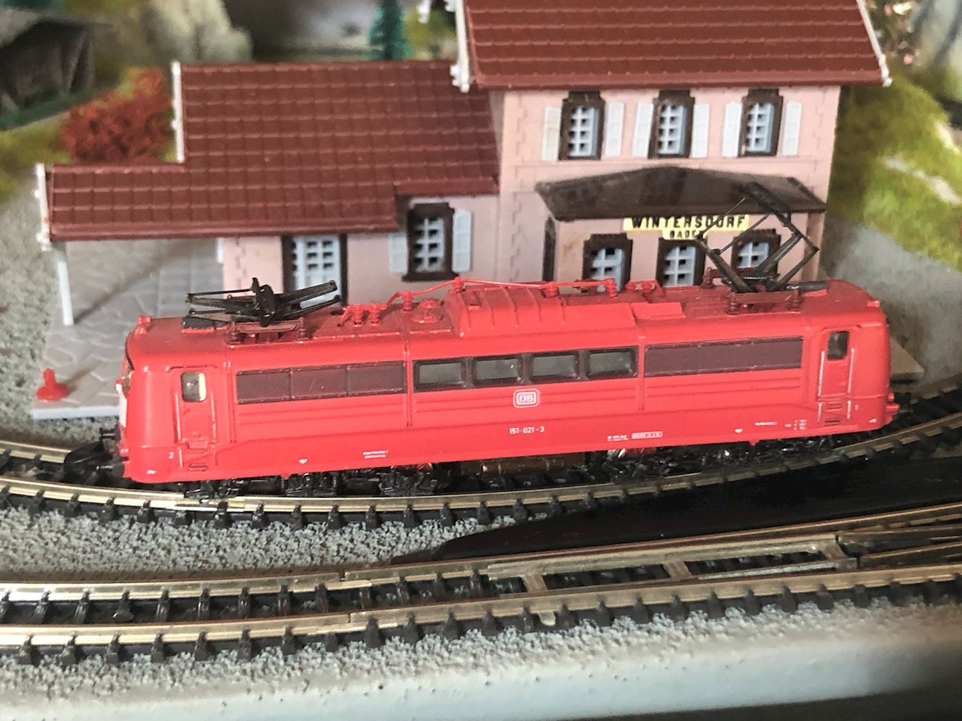

784E3912-5E23-4F3A-8E28-025B06E0FA59.jpegWith Märklin Z gauge Scheiner type pantographs the problem is keeping them down, they ping up with the smallest vibration.
ChrisG
