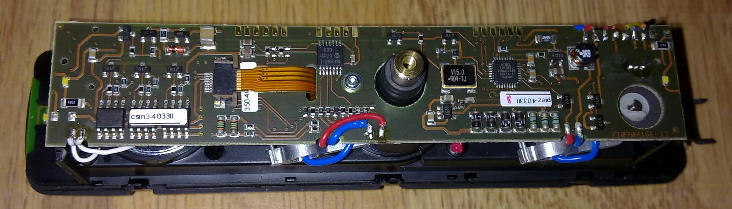

Note: I have multiple models using piezo motors (39970 Turmtriebwagen, 46715 Ardeltkran in yellow) and others using Servos (39008 BR 01 with changing level of coal in tender, 39126 BR E10 with motorized pantographs) and the operation is not that reliable (so it may be even worse if you do it yourself). So why why reduce the value of a high prized loco by chages you may regret later
Here is my Turmtriebwagen with its piezo motors
39970 FX Decoder and SDS Drivers.png (1,879kb) downloaded 20 time(s).
They are wearing rapidly (nose in aluminum). Three of them on this model.
Here it is in operation
