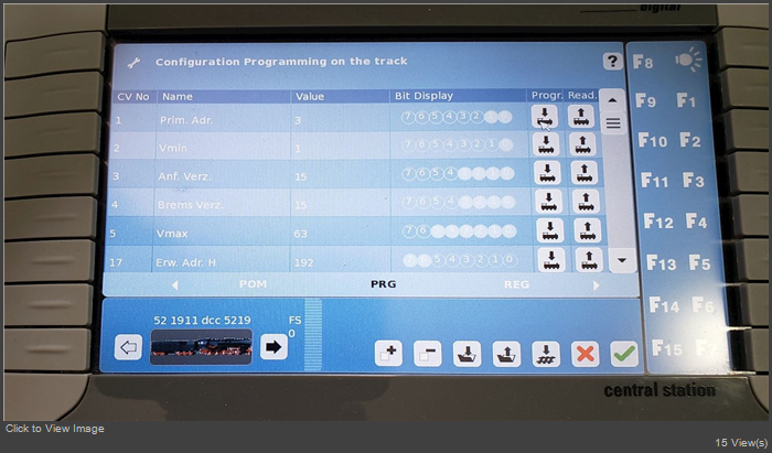

Well, I can't find anything or any way that helps shed any light on identifying this decoder.
#18 Posted : 07 February 2025 11:31:49(UTC)
Posts: 15,504
Did you read CV 8? What's the value?
Offline Willr
#19 Posted : 08 February 2025 17:08:04(UTC)
Willr
Joined: 03/03/2022(UTC)
Posts: 14
Location: Parry Sound, Ont. Canada
Originally Posted by: Willr Go to Quoted Post
I'm not able to find CV 8 or 7 when I'm looking at the CV table in Prog or POM.
Yep. Märklin made that bit very complicated on the CS2.
There should be a "+" button or something to that effect, that allows you to add lines for CVs 7, 8, and anything else you need. You can save that list as a template for future use.
Hi Tom.
The 2nd screen shot is after I press "CV Access".
I'm sure I've pushed ever button. I can't find any place to add 7 or 8.
Thanks for any input you may have.
#20 Posted : 08 February 2025 20:25:00(UTC)
Posts: 15,504
It's been a while since I used that dialogue, but I think this is the button to add new lines to get additional CV numbers:

Ok, this time I scrolled after tapping that symbol and found some 0 cvs. entered an 8, tried to download from loco, got an error message
that transfer was not successful. I'm not sure if that's correct procedure. I can't find any documentation.
