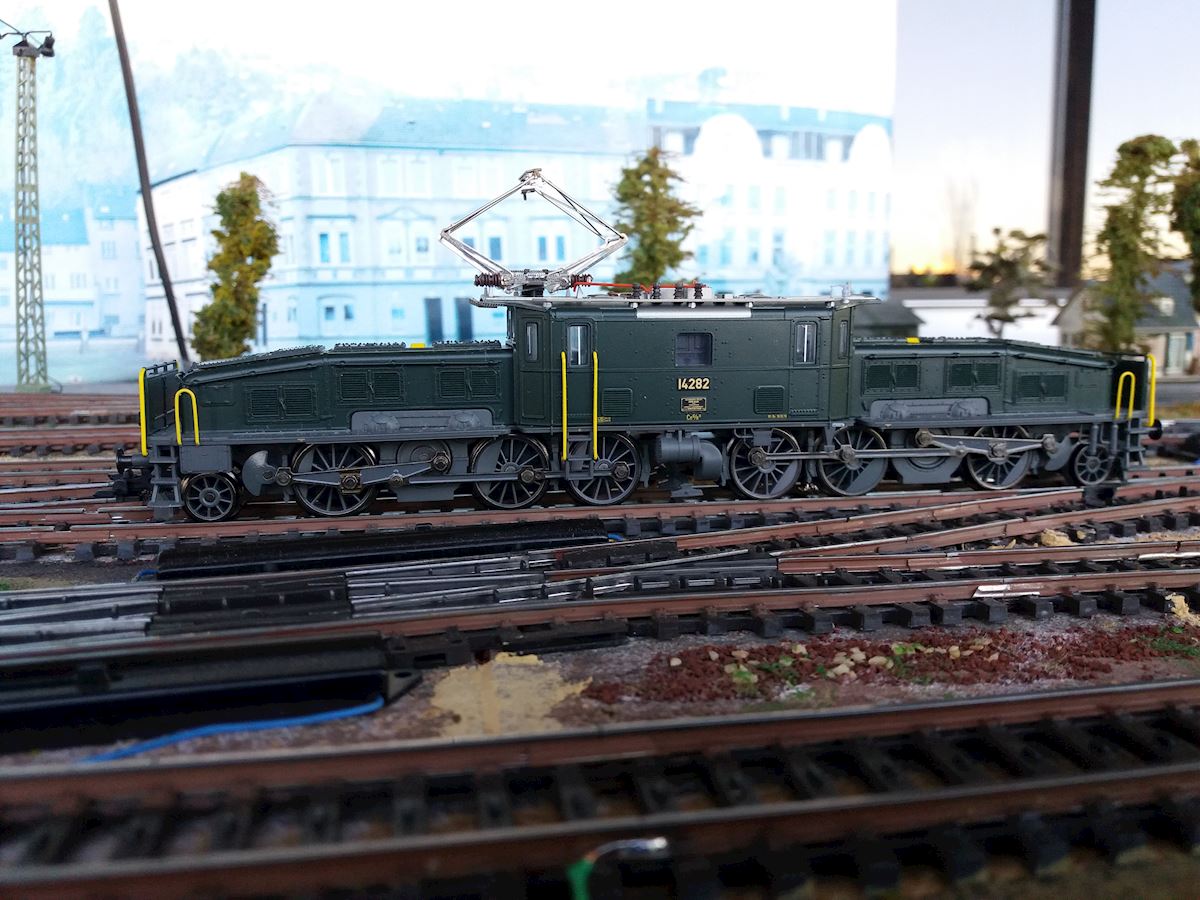

Hello
My last acquisition the crocodile insider 39567, is an incredible model full of details, my central is the IntelliBox (IB) I used the DCC option, and this way I can access all functions (28) of the locomotive, the pantograph rises very smoothly with a light rebound at the end. I changed the DCC address and adjusted the volume of the sounds.
Some pics:
But I have a little trouble:
I can always read the decoder CVs. No problem here.
When writing CVs I get an error message most of the time and don't write the CV.
Very rarely gives the error message and does write the CV (???)
He rarely writes CVs well without error.
Due to this problem, configuring the decoder correctly is tedious.
I think some time ago this problem was discussed and had to do with the input impedance and was solved by connecting a resistor in series with the programming track, but I'm not sure about that.
And finally, does anyone know the maximum speed of this locomotive?
Best regards and happy new year
