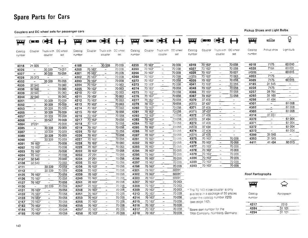

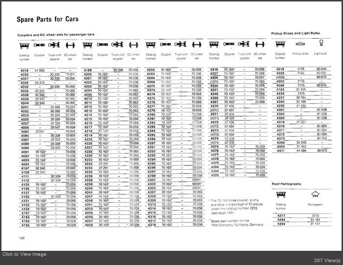

@ youngagain,
Most every Märklin catalog has a list of coupler parts ... see attached (from 94-95 catalog).
The "hook & loop" coupler kbvrod spoke about are pictured upper right on the first page ...
You will hopefully find your happiness in there. ThumpUp
Yum Wink
