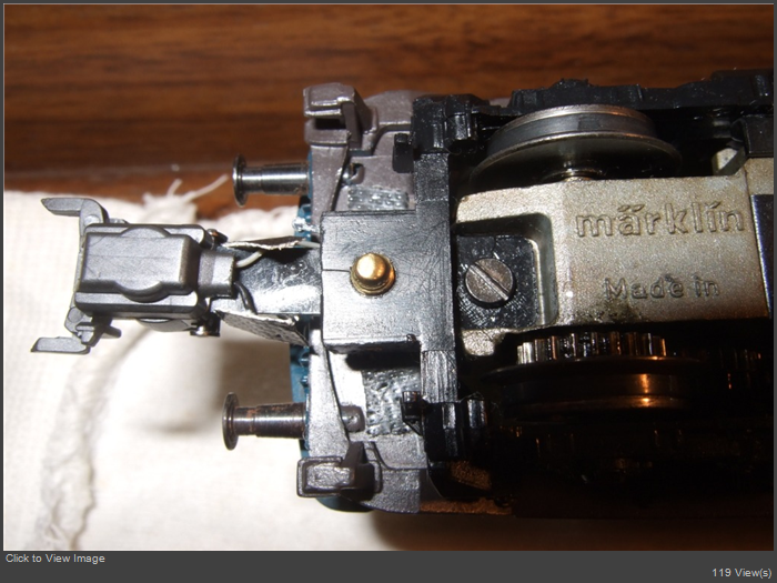

I have just acquired some lighted carriages BUT have a slider and earth plate on each carriage.
I would like to change the couplings, mounted on hte Bogie to NEM Pockets so I can use some form of CCC, either RTS or the Mearklin 2 pole coupling.
I would be running the connecting wires through the hole in the bogie
I have asked around by email to friends if they know if there is a conversion part.
Attaching a Photo of the bogie with the existing coupling where I would like to put a NEM Pocket. Would also need the part number to get.
Propably would not have to be Marklin.
Thanks,
Nev
PS I know the axles are rusty and need lubed.

#7 Posted : 27 January 2013 00:33:54(UTC)
Some sources say that 402660 (E402660) is the required part.
http://www.stummiforum.d...pic.php?p=360707#p360707
Other sources say that 7205 has a smaller hole than 402660.
I'm confused. Did anybody try those 402660?
402660 is not the part I want. If you look at my photo carefully the coupling is pinned to the bogie with about a 1.5 mm split post. no big hole.
Will try to find pictures of the others.
I suppose one way would be to super glue a NEM Pocket one on.
N
back to the sleuthing
the present coupling on the carriage is NOT a 7205

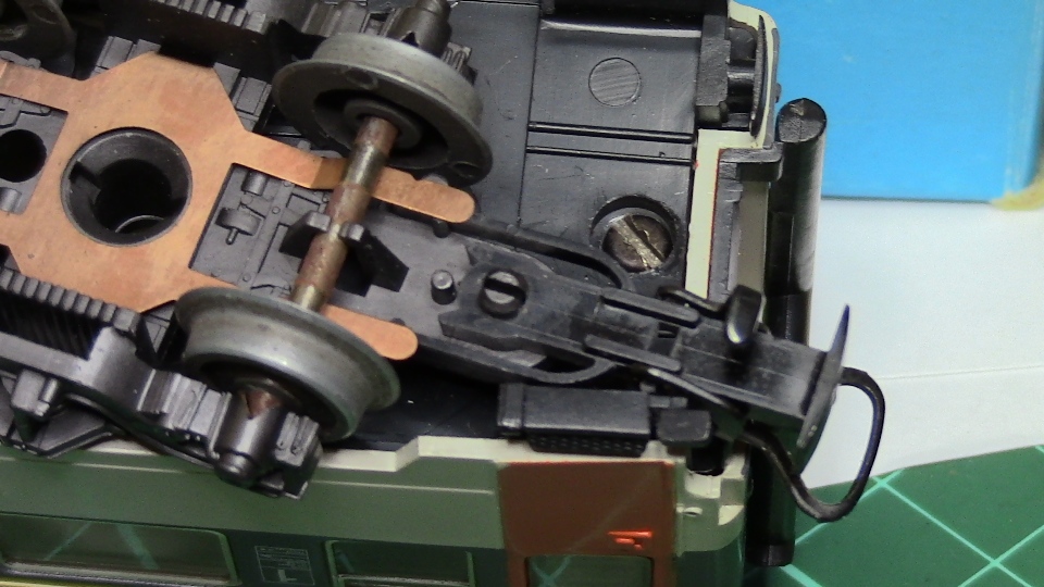

#8 Posted : 27 January 2013 07:44:43(UTC)
Posts: 15,488
Do you have a spare part number for the coupler you have? To me it looks like a 7205 would fit.
Here's a picture of the 402660 (bottom). Is the coupler you have different from the one at the top? To me it looks like the Märklin standard coupler they also use for the Hobby beer cars.
Märklin 402660
The 7205 replaces 701570 and 701580 and works fine with beer cars and similar Hobby cars.
A Benzingring Nr. 608020 was mentioned in connection with 402660, but was not confirmed.
http://www.stummiforum.d...pic.php?p=581484#p581484
#9 Posted : 27 January 2013 21:58:16(UTC)
Tom,
My coupler has NO Big hole, held on by a split post that looks like a slotted screw in the photo. I will take it off today and take a photo.
Thanks,
Nev

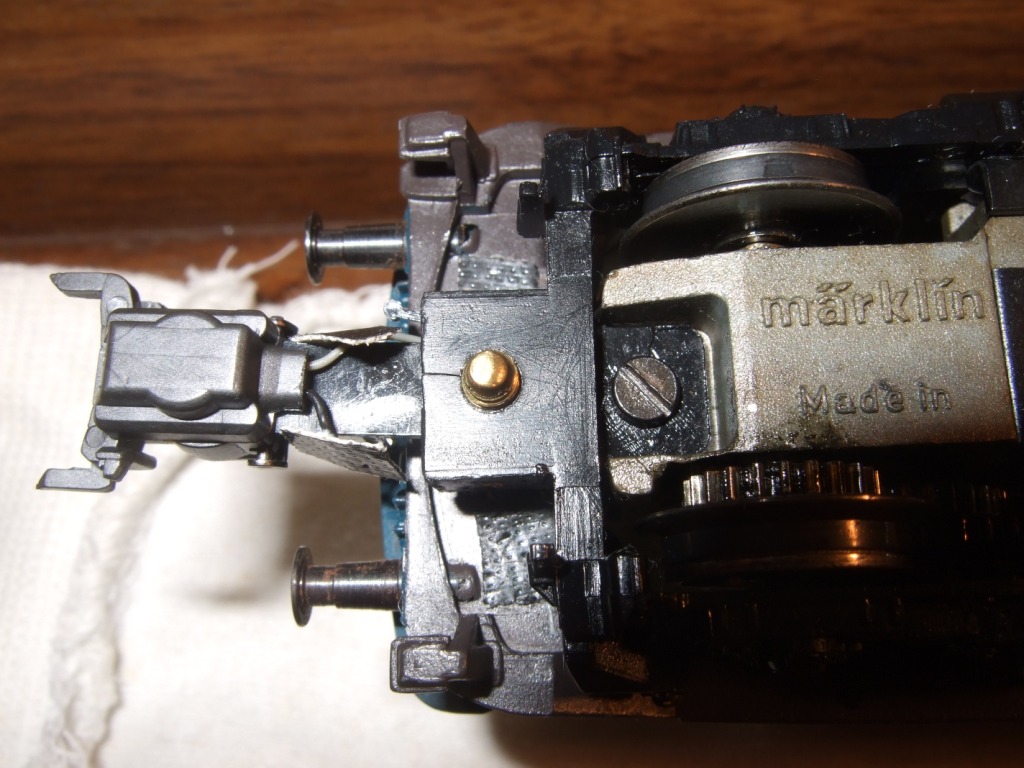

Offline solentgreen
#18 Posted : 16 February 2013 07:26:09(UTC)
solentgreen
Hong Kong
Joined: 26/12/2008(UTC)
Posts: 32
Location: Hong Kong,
Hello all,
I tend to agree with nevw that there are advantages in limiting the number of pick-up shoes/sliders. Apart from the drag, sometimes there is a chance the pick-up shoe getting misaligned and causing shorts, especially the ones that are clipped on as is the case with some of the long passenger carriages .
By the way, Tom, thanks for advising re part 671860 being right for a 3074 loco. You are right this is the right part for the job; I spent quite sometime searching but did not find and learn of this part so I had to use a 345760 and modify the 3074 suspension moulding to fit; I have attached a photo of the end result fitted with a 117993 Telex coupler (excuse the untidy bit of tape used to keep the 117993 wires in place; its been tidied up since!). Thankfully, it works fine.
Bennett.
