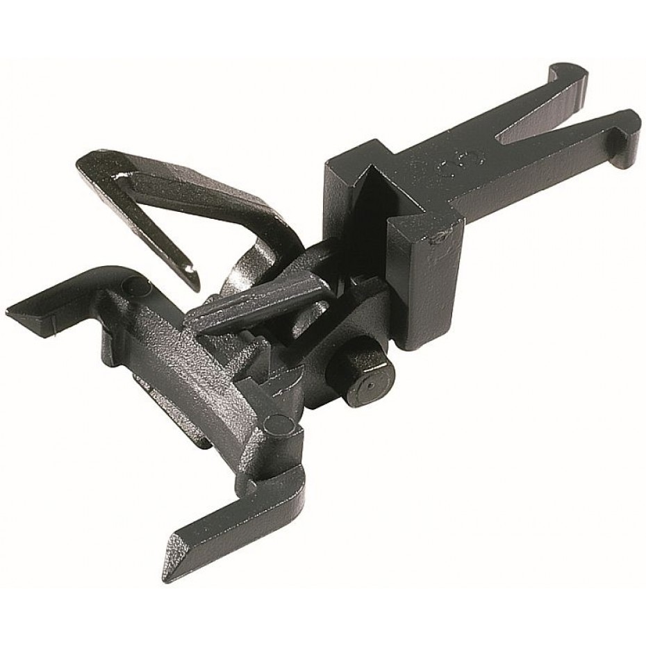

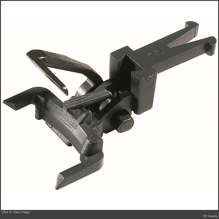

Over the years I've tried different couplings and the design has also changed in these years, my application is most probably slightly different from the average user as I have trains some with extreme weight and this means I need reliable couplings.
the couplings I've used (not including 4 pin couplings or my own created 8 pin couplings) have been from Fleischmann, Märklin & Roco.,
the result was the Fleishcmann couplings and Roco couplings uncoupled in curves., M♪2rklin couplings just uncoupled for no particular reason, the latest Roco coupling however is the most reliable one I've found and have no or I'm in the process of changing all couplings to this type, the difference is when 2 carriages are coupled together both couplings engage, for instance if one fails the other one is still hanging onto it.
this one has a height adjustment option

I have tried the Roco universal coupling. It is very good, very discreet, compatible with the Märklin short coupling, more compact that the Märklin one (no interference with bumpers) BUT VERY FRAGILE. So IMO it is a suitable option but be prepared to exchange them as soon as they have been pulled on.

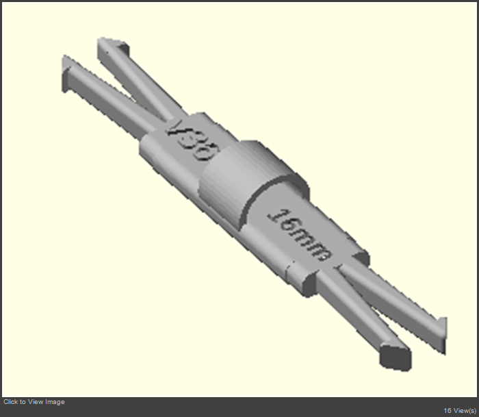

I have only used Märklin couplers and only Märklin rolling stock and have never had any real issues at all.
If one does not uncouple rakes of coaches or whole trains often, I think permanent couplers are the way to go.
The ones I designed have a 16mm length between the NEM pockets. My son sells these at:
https://scalethings.square.site/shop/couplers/6
They have an additional loop to hold wires that you may want to run along the train for lighting.
If someone would like longer or shorter ones they can contact me (or my son via his site) and we can create them at any length.
