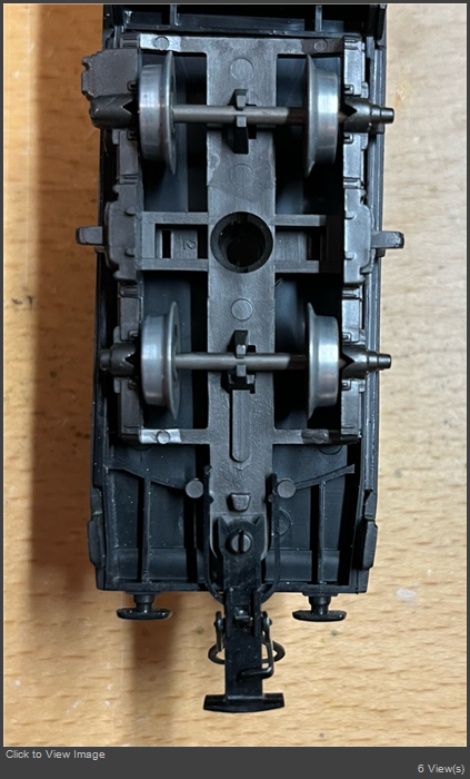

I have some older Märklin 4074 autotransportwagen, and it would be nice to have a more narrow distance between the cars. Would you know if there are any shorter couplings available for these kind of cars? NEM pockets are not required here…

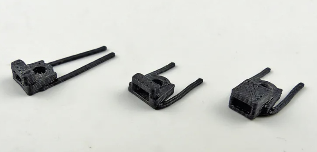

I ended up with an eBay seller of printed NEM adapters, who I have purchased adapters from in the past. He has a very good description of Märklin couplings for the autotransportwagen, and offers three different adapters for these cars. From the description, I find out that I actually need a few of all three kinds of adapters, as I’m now aware I have not only the Märklin 4074, but also other article # of autotransportwagen (see image below). I will follow up, once they arrive!

Thx Mike! As you can see in my previous posting is that different couplings are required, as there are three different types of couplings on these cars; Different length of the drawbar, different length of the springs. This is what I hope my German friend will solve with his 3D printings.

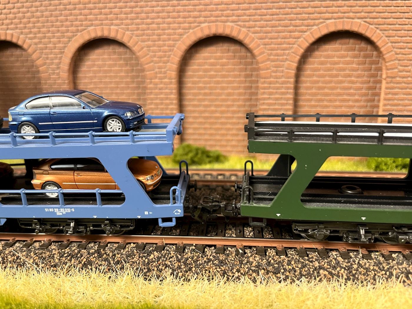

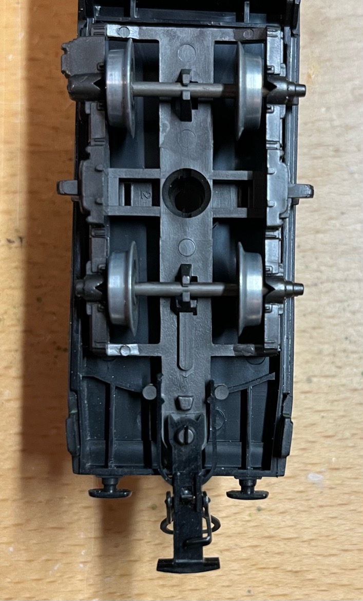

I received the coupling adapters of three different types from the seller linked in post #4 above. As the pocket is very short on all adapters, the coupling NEM male has to be cut a bit and then glued into the pocket. I’m very happy with the result, you can see the comparison below. On R1 the cars don’t touch, as you also can see below from the ”drone” pic.
Smile
The adapters
Before
After
Drone on R1
