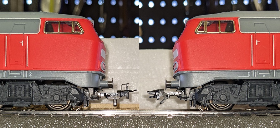

Coupler changed - no random uncoupling now.
A 2mm drill is the thing to get the old ones out - but be very careful not to enlarge the hole in the bogie while you're doing it.
The picture doesn't show it well but the coupler is at a bit better height, works well and close coupling is a bonus.
Thanks again to everyone.
