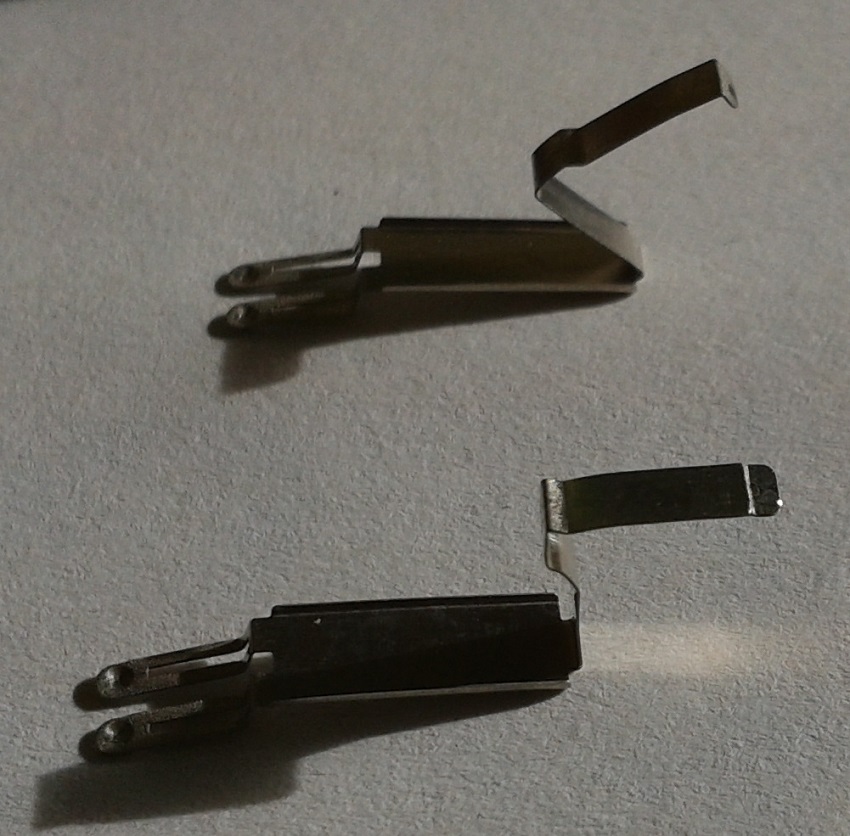

#1 Posted : 25 August 2016 11:03:22(UTC)
Posts: 8,698
Does anyone know what the part number for the contact that goes in the coupling pocket on the 42755 Orient Express coach set is (see photo)
Unfortunately (as you can see) I have some mangled ones, and the setup is entirely different, because these are Trix originated coach designs, to how Marklin do it. I expect the blue set that came out last year have the same system.
I'm up for buying a packet of them, as I also have a couple of coaches in the Trix version of the add-on set to convert, using the E series part number, if only I can find it out. I have emailed service at Marklin and got an automated reply, but no information as yet.

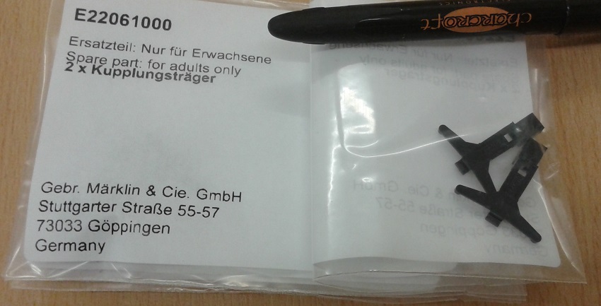

#4 Posted : 05 September 2016 19:08:17(UTC)
Posts: 8,698
I also found the part number E22061000 but don't have an image of it to see if it's the right one...
(Ersatzteilliste)
Walter
For the future reference of anyone searching the forum for similar information, E22061000 is the part number Marklin have given me for these contact pieces. Apparently they come in a pack of two, i.e. enough to repair one coach.
[edit]
This is not the part needed, that part number is for the plastic coupler pocket.

#6 Posted : 07 October 2016 18:41:34(UTC)
Posts: 8,698
Update, just edited the post above - the part number Marklin gave me is for the plastic coupler pocket!!! Angry Angry Angry Angry Angry

Offline eduard71
#10 Posted : 13 October 2016 18:24:55(UTC)
eduard71
Chile
Joined: 27/02/2008(UTC)
Posts: 299
Location: Santiago
Hi Allan,
As I can see in your photos, your connectors are not mangled but bent. I had the same problem in my Orient Express but I was able to fix the conducting connector using a set of mini pliers to unbent them and now they work just fine. After that I used current conducting couplers so it will be no necessary to connect and disconnect conducting bars that comes with this train.
Your problem is common on all Trix coaches with current conductors, I have had this problem also in my King Ludwig set and on some other Trix coache.
Eduardo

Yes, I expect to straighten these ones and fit conducting couplers.
However I also have a couple of matching Trix coaches that I want to fit with conducting couplers to attach to the Marklin coaches. To do this I need to fit these bits to the coupler pockets on the Trix coaches as they are arranged for each coach to do its own pick up of power.
