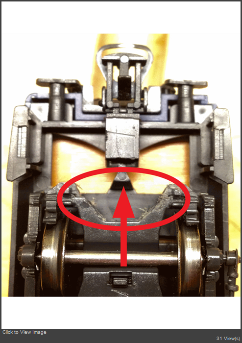

the AC axles have arrived. I have checked with a caliper that the inner face distance is what Marklin prescribes, tweaked the ones that were not correct and replaced the original ones with the new ones. Everything worked perfectly. While waiting for the axles with a dremel I reduced the frame of the bogie so that the coupler mechanism does not interfere with it over sharp curves.
I re-inserted the Roco short couplers, re-attached the buffers and everything works fine.

the photo illustrates better what I did. Te oval indicates the area that I enlarged with the dremel and the arrow the coupling mechanism that interfered, in my opinoin, with the bogie. Everything moves better now.
