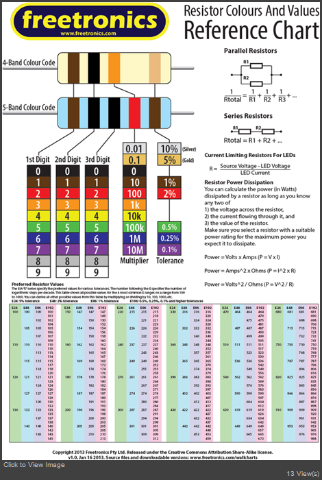

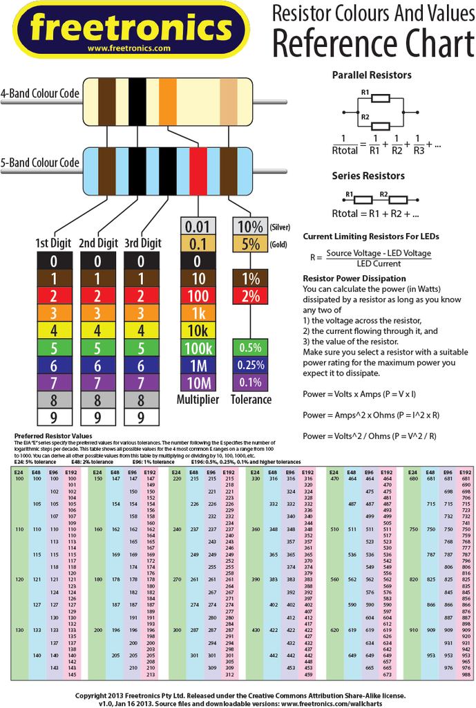

#11 Posted : 08 September 2021 17:50:13(UTC)
Posts: 8,624
Originally Posted by: tinroofrusted Go to Quoted Post
Thomas, the resistor color is tan. The bands are red, and silver.
Thanks, Marklinist5999. I have a picture and will get them this weekend. Your help has been of great value. T
See the attached colour chart. I think the tan colour mentioned is the colour of the body, but that could be any colour.
Resistors normally come as per the top image in the attachment, and for 2k2 you will have three red bands, then probably a gold band for the fourth one. I don't think anyone does resistors of wider than 5% tolerance these days.
If you end up with one according the lower image you will end up with red-red-brown-black and then brown or red for the fifth band would be most likely. I would be surprised if you got a gold or silver fifth band as the extra precision in specifying the vale normally means it will be closer tolerance as well.
