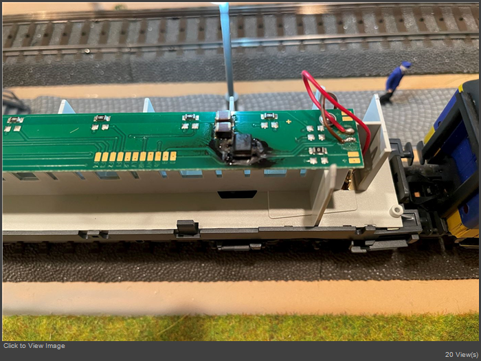

The middle one of the passenger cars in a Marklin NL three passenger car set with electrical conducting couplers I purchased about a year ago had the lights go out. It clearly wasn't a bad connection as the two cars on either end still had a power connection, and I smelled a funny smell. So I opened it up and found that one of the electrical points had literally melted and was slightly smoldering, which was the source of the smell. It was so hot, I was surprised it did not erupt into flames. You can see the burned spot in the picture below (if my upload worked).
I guess I will just replace it, but has anyone seen this happen before? It is a bit concerning.IMG_0690.jpg

Well, it is not unknown for electronic components to fail, and sometimes they will burn in the manner you show.
is it classed as an MHI item? Is the lighting factory fitted?
How old is this set? If less than 5 years old it will be under warranty if an MHI item.
Personally if the answers to the above questions are all 'yes' then I would return it to Marklin for a warranty replacement. The board doesn't look like like any of the catalogue lighting kits available, so will need a factory replacement.

Well, if it wasn't caused by a short, then i think it's a rare occurence. Still, I'd also be upset.

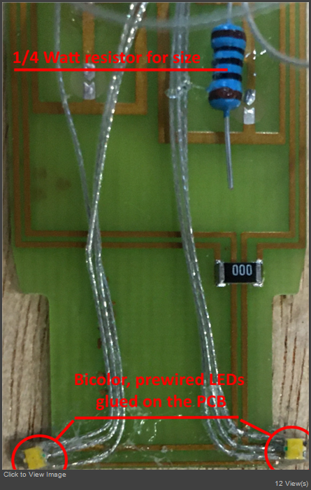

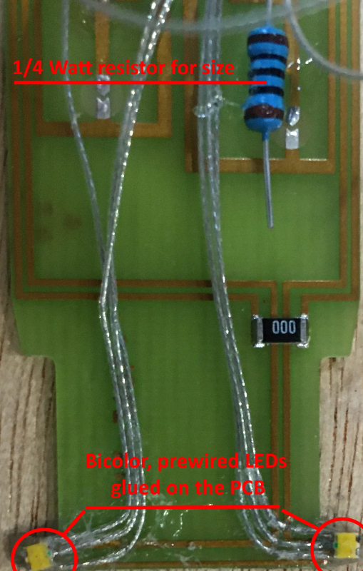

Something similar happened on my Kittel 3425 (my fault) on the headlights.
They were tiny surface-mounted yellow LEDs. Excess current made them burn and destroy the copper trace of the PCB
So I took the opportunity to install dual color LEDs instead
Here is the work in progress
What I am trying to say is: if the coach is not under warranty, you may try to fix it yourself
In your case, I am not sure but the burned 4 legs component looks like a rectifier bridge that had excessive current.
They are easy to find on ebay.
