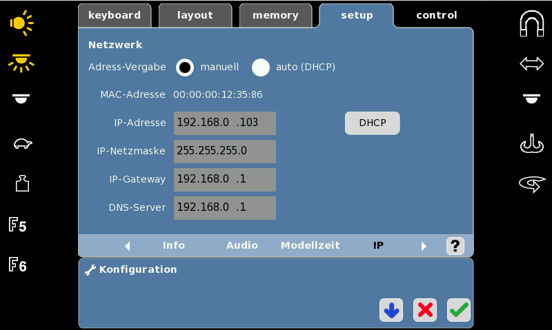

Hi Stan
You have basically 2 ways
ONE is to connect your CS2 to the Internet (the auto mode is preferable to manual mode as it leaves your router or Internet box assign the IP address to your CS2.
Then power-up
Then select SETUP and then UPDATE and Network to start the update
Note: because no updates were made for a long time, be prepared for multiple reboots and updates. Also do this only if you have a good internet connection. Otherwise the USB memory solution is better.
WARNING: be patient because a normal Update can last 30 to 45 minutes and in your case even longer. If the CS2 reboots let it alone until the success is displayed
