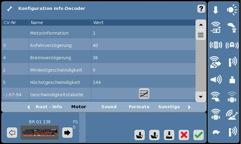

#5 Posted : 04 November 2022 13:53:29(UTC)
Posts: 3,739
Sorry I realized you use a CS2 so here are the key variables (sorry German version)
- Anfahrverzögreung = Acceleration delay
- Bremsverzögerung = Brake delay
- Mindestgeschwindigkeit = minimum speed ATTENTION Don't set too low so the loco will avoid stalling (starts all the times)
- Höchstgeschindigkeit = maximum speed
Here is the speed curve
