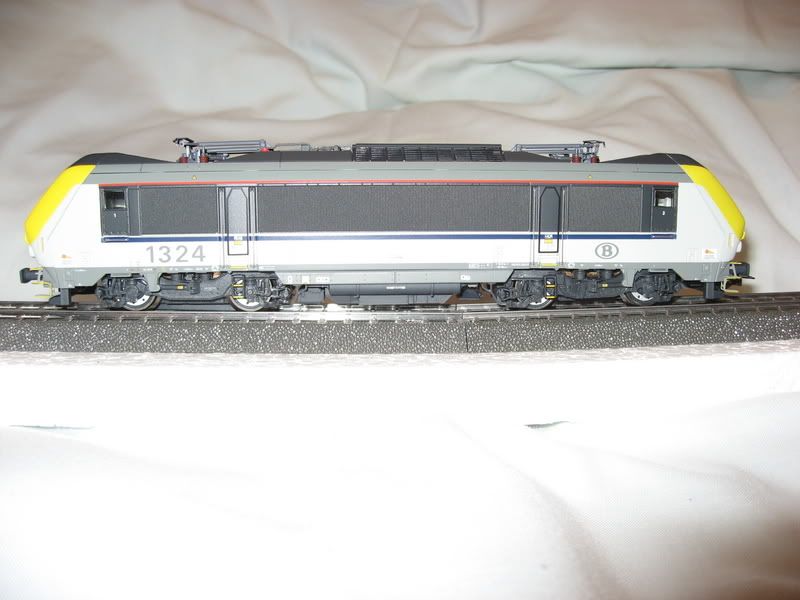

I just returned from a short business trip to Belgium and I couldn't resist a couple of non-Marklin items.
I brought back the LS Lok Series 13 and a Heris made coach. Very nice pieces for my collection and a reminder of the trip.
Here are a couple of pictures - quality not so good but I'm practicing.

Rgds,
JonnyMac
