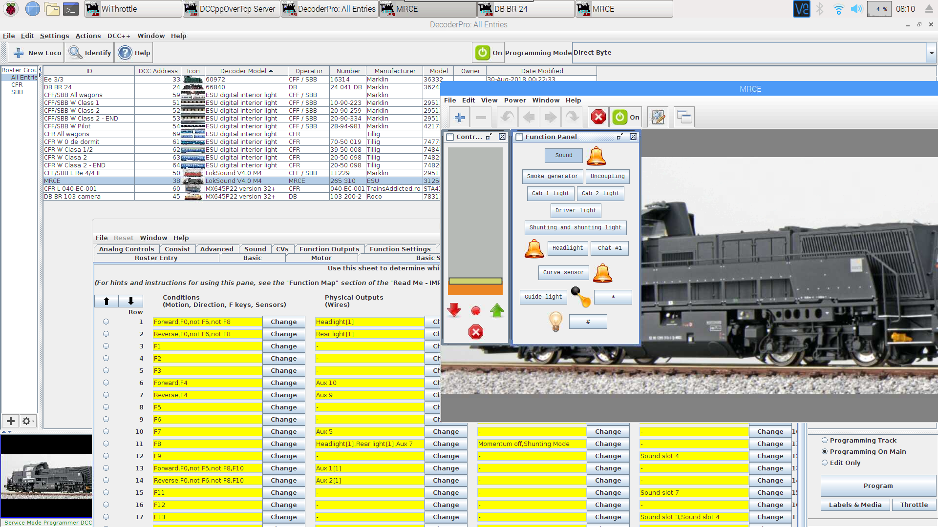

Since you are willing to jump off the mfx wagon I suggest JMRI on Raspberry Pi and DCC++. The whole package will set you back between 30 and 50 ($, EUR, whatever), depending on the RPi model you get.
WiFi included for free. As many throttles as mobile devices you have around. Separate programming track. Graphical interface as large as your TV. Remote desktop connection if you don't have/want to connect to the TV.
If you want to test it out just run JMRI on your computer with the DCC++ Arduino on USB. You can experiment with all the above for a few bucks only and if you are not happy with the solution move along to any of the above brands.
.costin

And to illustrate the programming and control panels of JMRI here is a screenshot of it with one of the locos. I can't imagine programming CVs without it, especially in complex decoders like ESU's.
