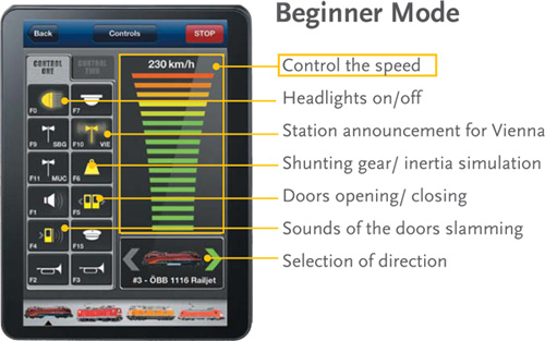

Z21 Experts System
It took 2 minutes to connect everything together - power in, LAN cable from Z21 to router as directed, track (I used Marklin C track) connection into Z21 Main Line.
Next up was to download Z21 application from Google app store (it is free) to my 2 year old Samsung phone (it also works with iPhone, iPad, all Android phones and tablets).
You then turn on Wi-Fi on the phone, open up Wireless Networks settings, find that now you have this new Z21 network, connect to it with supplied password, and that's it.
I had one of the Marklin mfx locos lying around, so put it on track and in the downloaded app I entered its address and quickly setup some sound functions on the app screen.
Z21 offered to take a picture of my new loco and, this being smart phone, it imported taken image, cropped it automatically ThumpUp and there it was.
Z21 Locomotives
Once you setup all your locos and other digital appliances, it is time to play BigGrin
Pressing "Control" loads up digital inventory, you select the loco (I only had my Marklin loco and another Roco AC loco entered in). Control screen has throttle, direction control, functions icons and emergency stop. On a side it has small tab to switch to layout (turnouts, signals, etc) control mode. On the bottom there are icons of all your other locos; you swipe right/left to select the one you wish to control and off you go. On iPad (borrowed with considerable difficulty from my daughter) you can control two locos side by side.
I was mightily impressed. One of the things I did was to walk away with phone in hand to the other side of the basement, around the corner, and still I had connection to router and still was able to control my layout. Imagine getting few train buddies together armed with their smartphones walking around layout and operating different pieces of it!Cool
