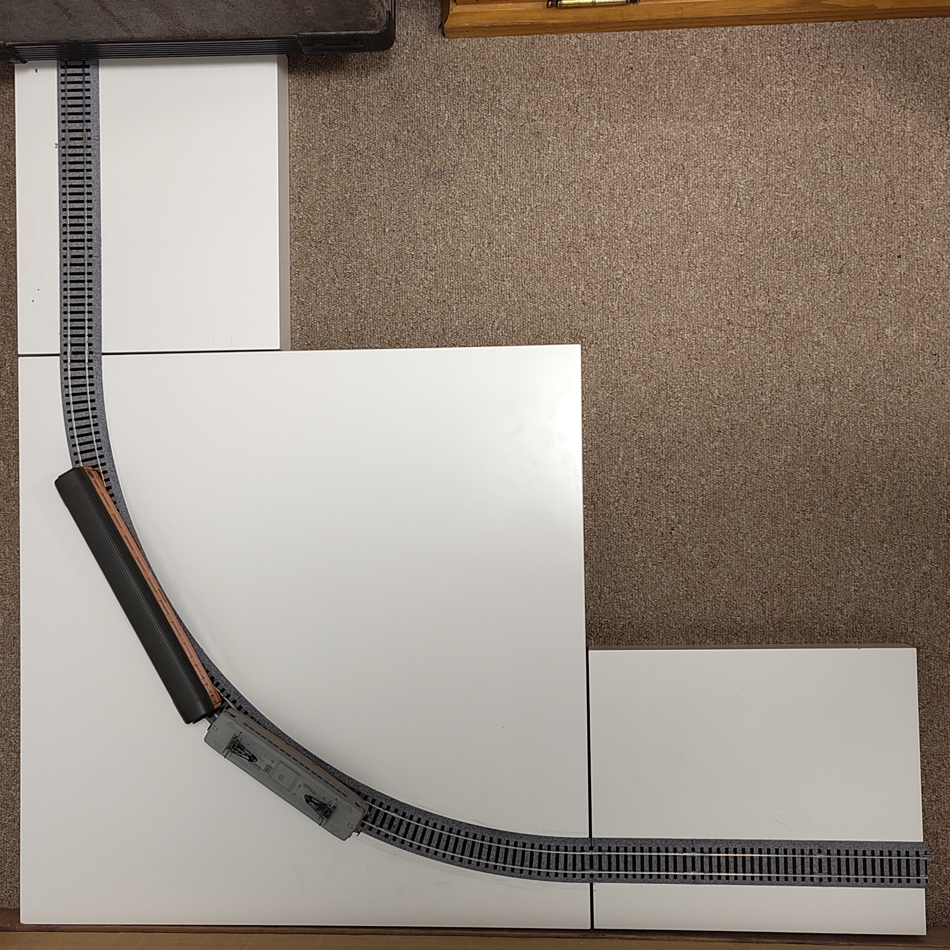

I would even be considering combining LACK products—e.g., 26 cm boards with the 90 x 55 cm table—to create a reversing loop and similar"heretic" features. RollEyes

I obviously ordered a few bits of cheap Unitrack on eBay to make sure my loco's would run on it - and here's what the boards look like - LUCK on the left and 2-rail CLACK on the right.
Two IKEA LACK 300mm baseboards, one with KATO UniTrack spaced 42mm from the edge and one with TRIX C-Track spaced 15mm from the edge.
Losing a chunk of contiguous scenic area is sad, but gaining enough space on the far side for a platform and low-relief station building might offset that effectively. Flexitrack can easily be used on larger boards to create a bigger diorama area anyway. Rail code is the same between TRIX and KATO, with the same outcome - my Tri-ang 3F won't run on it, but my other stock will.
And one side benefit, Unitram and OO9 Unitrack don't have complete sets for LUCK, but N gauge Unitrack does (i.e. matching the H0 track length to the mm!) and the joiners can be removed for mixing modules - so it should be possible to create a version of the standard that is multigauge, with a few caveats. Plus - the N gauge parts will mix with the other two (and flexitrack) so there's easy ways round that.
So; I think replacing CLACK with MLACK and LUCK suits me fine. Even if y'all find the magic fix for C-Track, since you're all three rail all your losing from the system is my pass-through dioramas and I just bought my first static grass applicator today - which; tells you about my skill level haha
thanks 4 users liked this useful post by EB421

From Team Two Track, I have found glue that works (slow tack superglue gel, who could have seen that coming), track that works (geometry has been pretty thoroughly tested now for Unitrack H0) and my printed spacers work. So (ignoring the nicks in the finish from removing the C-Track and the awful spray-glue I tried to attach it with...):
The first LUCK module - a bare LUCK300 with track but no scenery.
This is what a LUCK module looks like!
thanks 2 users liked this useful post by EB421

Sleep wasn't coming too easily last night, so a third module got track glued. Slightly harder to do the LUCK550 corner module than the LUCK300 dioramas; but I managed without too much trouble. I need to get a little more efficient with the glue, but I'm happy at least that it's well-stuck-down!
Three modules counts as a 'layout', right?
A LUCK550 module with a LUCK300 module on each corner.
For my next LUCK300 module (I have three shelves left), I'm going to do a mix of Unitrack and Peco SL-8300 Flexitrack as a proof of concept for doing bigger LUCK1100 and LUCK1900 modules. I also want to put some lighting and maybe a complication on that one, so using mixed-track allows me to solder to the Peco for power breakout rather than buying a set of terminal Unijoiners just to run two centimetres under the station platform.
thanks 3 users liked this useful post by EB421
