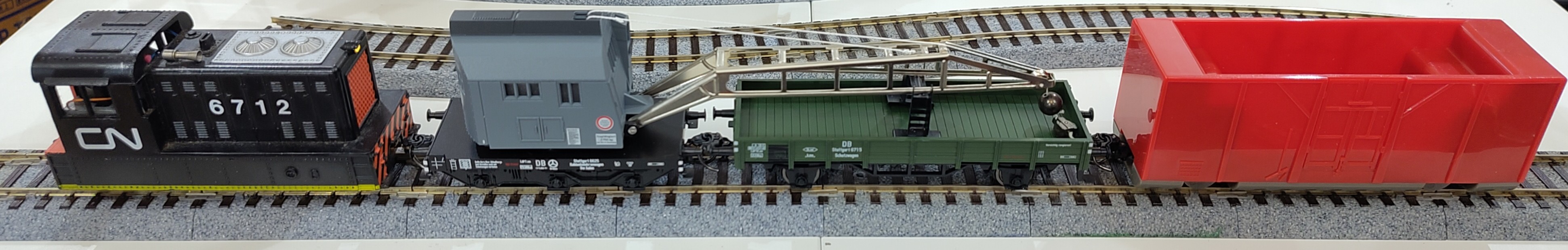

Funnily enough, this idea led me to this page: https://www.marklin-user...Marklin-M-Track-5106-1-1
Which led me to the 1956 catalog, where one can find a picture of my Marklin cranes! I wonder if the designer all those years ago ever imagined that I'd be running it on 2-rail track. Or; perhaps more confusingly, that the thing would have an onboard supercomputer (by 1956 standards) that would let it be a fully operable crane that could pick things up, move them somewhere else in a layout and drop them off again without a single touch of a human hand!
Looking at this again, the geometry of the points works out too - you should be able to fit a short side-track off a set of points on a 300mm. Not big, but enough to hold a SWB wagon.
Honestly no notes on the idea. It actually looks a lot better than CLACK for 3-rail. Though - can I propose "MACK" instead of MLACK? MACK is a cute androgynous name, and MLACK makes me worry about swallowing my tongue. :P

Continuing the "reasons I'm glad I switched to Unitrack for the 2-rail variant" thread... here's my Unitrack test train in all it's glory:
The unitrack test train. Details in post.
Self-evidently we have a Model Power Porter Hustler (now sold by Evemodel), a Marklin Start-Up DCC crane, and a Marklin myWorld Adapter Wagon.
And the reason-this-makes-me-glad is - the myWorld stock doesn't work as well on TRIX C-Track as on Marklin. the flanges bounce off the chairs like the 1950's Tri-ang does - albeit not as bad. But, it has no problems with Unitrack. So - go figure!
thanks 1 user liked this useful post by EB421
